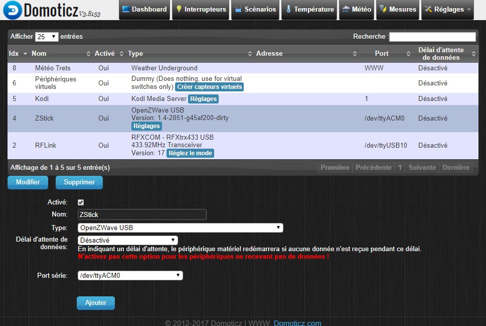

Please note that OS is a virtual machine, but USB device (RFXtrx433 and ZWave dongle are mounted and seen by system).
After install, I've restored domoticz db to new system saved from the raspberry

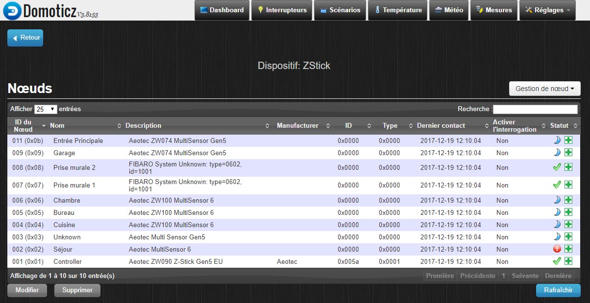

The install seems to be fine, Domoticz runs normally and there is no pb with RFXcom, script... . But, except zwave controller (Aetoec Z-Stick Gen5), all devices haven't IDs, nor TYPEs. And so, none values are recorded (devices seems to be unseen)
Clipboard 1.jpg (154.62 KiB) Viewed 2421 times
Clipboard 2.jpg (192.56 KiB) Viewed 2421 times
try searching solution in this forum, found some topics wich describe sames issues with recent release of Domoticz, then I have done new compil from last stable release (v3.8153) which is the same release of my Domoticz install on Raspberry.
I also try "Refresh Node Info" from OZW control panel but didn't resolve issue (give ERROR: Dropping command, expected response not received...)
Nodes topology seem to be ok
Someone could help me ?

I try it by renaming zwcfg_XXX.xml file (in Config dir), then reboot. After reboot, device aren't still not identified. A new xml config file is created, I open it, ID and TYPE are set to 0

ropske wrote: Tuesday 19 December 2017 13:38 Your device_manufacturer.xml is not up to date i think
I didn't find any device_manufacturer.xml file, did you mean manufacturer_specific.xml in Config dir ? I open it, and it seem to include my devices (note that I didn't have exotic devices, only Aeotec multisensor and fibaro plugs)
If not, where can I find this file, and how can I update it ?
