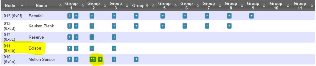

This works for me:
Just add the switch you want to associate to group 2 from the motion sensor. In the example this is node number 11. Then the switch will remain on for the on/off duration (Parameter 2) from the motion sensor. In my case this parameter is set to 300 seconds. So the switch stays on for 300 seconds when motion has been detected.
- Motion_Sensor.JPG (38.27 KiB) Viewed 1404 times

Is it possible to show a picture with the settings of the sensor?
