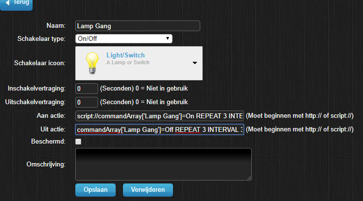

Hmm. How can I send more than one on signal or off signal per switch?

Use a script e.g. in Dzvents. Create a dummyswitch which you use to switch on and off.DaWauZ wrote: Monday 13 November 2017 10:24 Hmm. How can I send more than one on signal or off signal per switch?
Verstuurd vanaf mijn XT1562 met Tapatalk
Then use a script like the following to switch your devices multiple times.
active = true,
devices = {
'Huiskamer Lampen'
execute = function(domoticz, switch)
domoticz.log(switch.state)
if (switch.state == 'On') then
domoticz.devices('Lamp Achterkamer').switchOn()
domoticz.devices('Lamp Achterkamer').switchOn().afterSec(3)
domoticz.devices('Lamp Achterkamer').switchOn().afterSec(6)
domoticz.devices('Lamp Achterkamer').switchOn().afterSec(9)
domoticz.devices('Lamp Dressoir').switchOn()
domoticz.devices('Lamp Dressoir').switchOn().afterSec(3)
domoticz.devices('Lamp Dressoir').switchOn().afterSec(6)
domoticz.devices('Lamp Dressoir').switchOn().afterSec(9)
domoticz.devices('Lamp TV').switchOn()
domoticz.devices('Lamp TV').switchOn().afterSec(3)
domoticz.devices('Lamp TV').switchOn().afterSec(6)
domoticz.devices('Lamp TV').switchOn().afterSec(9)
domoticz.devices('Lamp Erker Wit Dim').switchOn()
domoticz.devices('Lamp Erker Wit Dim').switchOn().afterSec(10)
domoticz.devices('Lamp Erker Wit Dim').switchOn().afterSec(20)
domoticz.devices('Lamp Erker Wit Dim').switchOn().afterSec(30)
if (switch.state == 'Off') then
domoticz.devices('Lamp Achterkamer').switchOff()
domoticz.devices('Lamp Achterkamer').switchOff().afterSec(3)
domoticz.devices('Lamp Achterkamer').switchOff().afterSec(6)
domoticz.devices('Lamp Achterkamer').switchOff().afterSec(9)
domoticz.devices('Lamp Dressoir').switchOff()
domoticz.devices('Lamp Dressoir').switchOff().afterSec(3)
domoticz.devices('Lamp Dressoir').switchOff().afterSec(6)
domoticz.devices('Lamp Dressoir').switchOff().afterSec(9)
domoticz.devices('Lamp TV').switchOff()
domoticz.devices('Lamp TV').switchOff().afterSec(3)
domoticz.devices('Lamp TV').switchOff().afterSec(6)
domoticz.devices('Lamp TV').switchOff().afterSec(9)
domoticz.devices('Lamp Erker Wit Dim').switchOff()
domoticz.devices('Lamp Erker Wit Dim').switchOff().afterSec(10)
domoticz.devices('Lamp Erker Wit Dim').switchOff().afterSec(20)
domoticz.devices('Lamp Erker Wit Dim').switchOff().afterSec(30)
}- Siewert308SW

In normal Lua...DaWauZ wrote: Monday 13 November 2017 10:24 Hmm. How can I send more than one on signal or off signal per switch?
commandArray['MyDeviceName']=On REPEAT 3 INTERVAL 3'
repeat means how many times to repeat the signal.
Interval means the time between each signal command.

Can I use it here like this?Siewert308SW wrote: Monday 13 November 2017 11:39In normal Lua...DaWauZ wrote: Monday 13 November 2017 10:24 Hmm. How can I send more than one on signal or off signal per switch?
If yes, and want it to use the switch in a blockly, will it use this as above?
