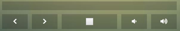

I started using the dashticz screen a while ago, and missed an easy way to cast directly to my chromecast audio. So I created a module, highly inspired by the streamplayer that is already integrated (it uses even the same streams from the config)
It looks like this:
Screen Shot 2017-11-10 at 16.25.01.png (159.91 KiB) Viewed 4574 times
The play button is changed to the default cast button from google. When clicking on it, the default casting screen from chrome pops up, where you can select the available chromecasts in your network. The arrows on the left let you select the streams, on the right side the volume buttons are available.
The block is available as 'chromecast' in the config, for example
columns[3]['blocks'] = ['chromecast'];
The code is available on github: https://github.com/aiolos/dashticz_v2/tree/chromecast
Rob, I can make a pull request to integrate it, just let me know. It might need some tweaks for the sizes of the elements, since I use dashticz in portrait, so only one column.

I guess it only works in Chrome, since that natively supports casting. I have not really looked into support on other browsers. I also noticed that if you add a direct link to the page on the home screen, the browser first needs to be started.

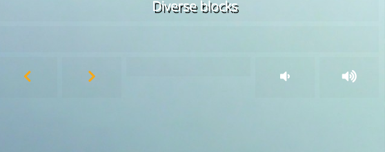

Only got this block to show

EdwinK wrote: Friday 09 November 2018 23:31 Screen Shot 2018-11-09 at 23.31.06.pngOnly got this block to show
Hi Edwin, did you (or anybody else) ever managed to get this working?
I have the same problem as you described..
Been searching now for over 2 hours but couldn't find a solution...
code used in config.js is:
columns[2] = {}
columns[2]['blocks'] = [frames.weather,'chromecast',calendars.afval]
columns[2]['width'] = 5;
Thanks in advance,
Marcom

Same here, I have no idea how to get this to work. Anybody got a working setup and is willing to share how you did it?
