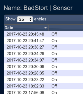

I am running on beta 3.8590
The device is correctly changing the status
Screen Shot 2017-10-23 at 20.47.09.png (34.31 KiB) Viewed 1652 times
Any ideas?
