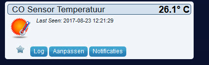

I bought a Fibaro CO sensor and installed it in Domoticz.

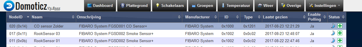

The Co sensor is found in OpenZWave usb module
and in Domoticz is showing found zwave co device
If i use the found devices i only get a device showing in temp. page
I can't find a device Co Sensor elswhere.
please help.

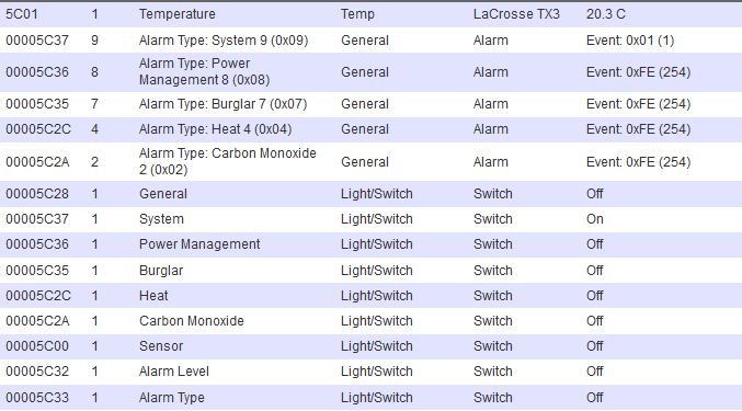

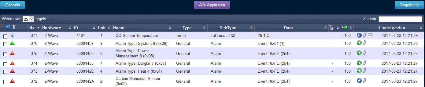

You should get more devices.
Wake it up a couple of times with the button in the middle.
You should also have switches for CO,burglar,heat e.d.
