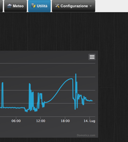

Take care this module sometimes send some absurd measures: Recently I got a 20MW measure for electric power! Must have a nuclear plant in my garden to be able to reach such figures...dotbeppe wrote: I'm not sure the measurements are correct
You then have to remove these points manually from domoticz graphs (shift+clic the point), otherwise all other points will appear flat because of auto-scale...

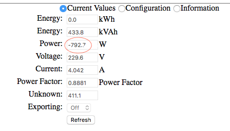

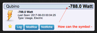

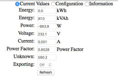

I do not understand why consumption is read in negative. ???
With the symbol --- before the number, I can not create events or counters

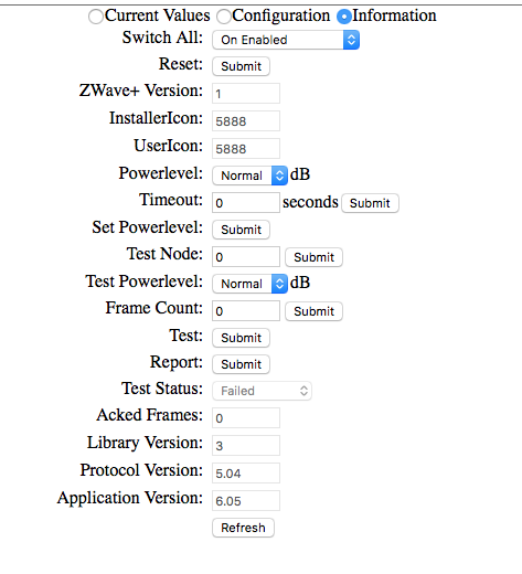

My version info (in OZW control panel/Information):
-Library version : 3
-Protocol version : 5.04
-Application version : 6.05
