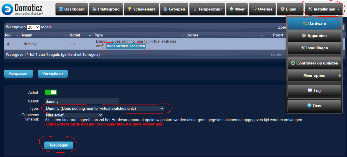

You have probably figured it out by now, but for anyone still looking how to make the thermostat script 'look and feel' as good as it controls your boiler: Add a dummy thermostat setpoint to your domoticz devices and use this from the script. Here are the steps:
1 - Add the 'Dummy' hardware (if you haven't got it installed yet):
Add dummy hardware & start adding a dummy device.png (81.28 KiB) Viewed 577 times
  • Click Instellingen (Setup)
  • Click Hardware
  • If your hardware list already contains the Dummy hardware, go to (2). You only need it installed once.
  • In the bottom half of the screen, enter a name for your hardware. I suggest to use 'Dummy'.
  • Behind 'Type', select "Dummy (Does nothing, use for virtual switches only)".
  • Click the Toevoegen (Add) button.
2 - Add a thermostat setpoint device
