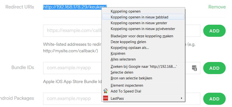

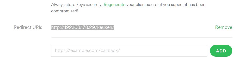

capman
Posts: 166
Location: Belgium
Re: Dashticz - Module - Spotify
Post by capman »
INVALID_CLIENT: Invalid redirect URL
I have the same problem. Try this. Select the redirect url with your mouse (example: http://192.168.178.29/keuken/) Then click with your right mouse key on it and choose option "open link in new tab'. Now spotify ask you if you give permission to open this link. Click OK button. Solved !
