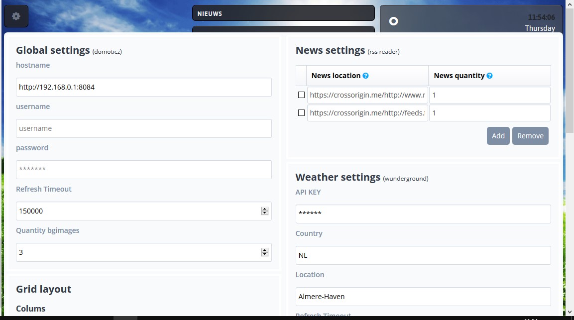

- step 6: Open the application and fill in your settings like the example listed below!
https://raw.githubusercontent.com/danie ... ttings.png
- step 7: If you have PHP installed just hit the Save Changes button or if you dont have it installed just download it manualy with the Download Manualy button and upload the config.json to the root of the application

The configuration page is displayed but nothing else
Does not save settings
I manually changed the IP: My Domoticz port, but I do not see any of my devices
The name of the config-default.json file has also changed to config.json
I changed the config.json file to 777 chmod
dycati

Kniazio can you please show me your console/network output when you save you settings page?
kniazio
Posts: 202
Joined: Thursday 06 October 2016 8:14
Domoticz version: 3.7243
Re: [ DomoDash ] a Angular tablet/mobile dashboard
Post by kniazio »
Please
I am typing IP of my Domoticz (192.168.1.100:8078)
I press Save
I have it:
So nothing.
