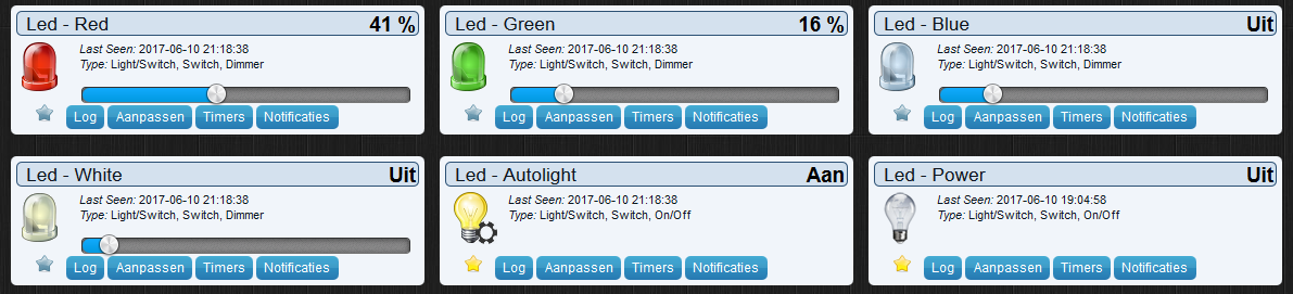

After installing the plugin you get a few switches: (beacuse the colorpicker won't work within python)
One for each color (red/green/blue/(warm)white), A global on/off switch and a auto option. This will turn on/off the light and changes color at a random interval. Made this beacuse I am lazy :)

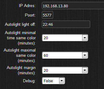

Settings:
For connection and for the automatic light option.
The automatic light option switches on based on the current sunset times. I am not able to retrieve them directly from Domoticz so I used a JSON call. To make this work you must update the domoticz username/password in the plugin.py
