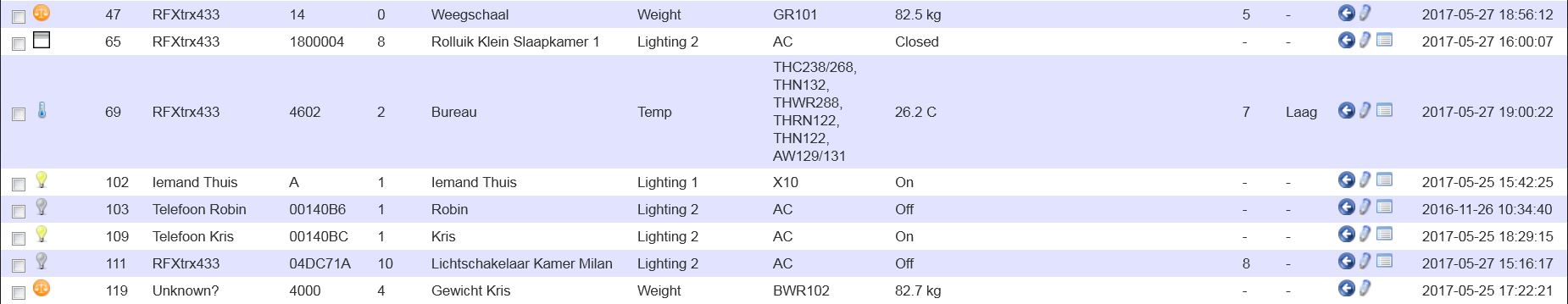

You are sure you have a device that is called "Gewicht Kris"? ( verify spaces,Caps en Lowercase!)
Jos
capman
Posts: 157
Location: Belgium
Re: Error in my scale script
Post by capman »
jvdz
Posts: 2445
Domoticz version: 4.107
Post by jvdz »
How did you create the device "Gewicht Kris" as it has an unknown for Hardware?
Shouldn't that be a Dummy Hardware device?
Jos
capman
Posts: 157
Location: Belgium
Post by capman »
jvdz wrote:How did you create the device "Gewicht Kris" as it has an unknown for Hardware?
Jos
