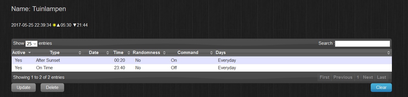

Can you post a screenshot of your scene/timer?
Greetz YcKe
Gravityz
Posts: 652
Domoticz version: 2025.1
Re: Qubino ZMNHAD1 switches instantly on and off
Post by Gravityz »
here it is
nothing complex

Gravityz wrote: ... tuinlampen.jpg
Is that configuration really meant to scheduled to switch on 20 minutes after sun set?
Since the value description of time means value (time) between 00:01 and 23.59 ...
Would be great if this is the way to delay action after sunrise or sunset.

Yes it is
time is indeed from 00:00-23:59
Type however describes the contect of that time
on time means: switch on exactly on the time specified
after sunset means: use the time specified as a delay after sunset
You have lot of other types
like
before sunset
after sunset
before dunrise
after sunrise
fixed date/time
odd week number
etc etc

Gravityz wrote:... Yes it is
Confirmed. Yes it is working pretty good for me. And finally I have got e quite simple blockly to move my shutter up and down on a certain time after sunset and sunrise. Needed to use a virtual day/night switch with time functionality, a user variable and a group with open/close percentage for my shutter ...
