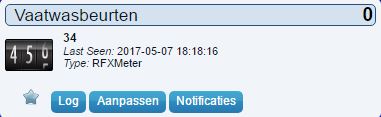

i made some counters and for some reason there is no data in the day usage.
Please find pictures in attachment
Total count as overview is now at 34 and that's correct.
But day usage keeps telling 0
Someone knows what i'm doing wrong?
Thank you

- 2017-05-08 09_27_44-Clipboard.jpg (9.8 KiB) Viewed 2526 times
- 2017-05-08 09_26_15-Clipboard.jpg (33.1 KiB) Viewed 2526 times
- 2017-05-08 09_24_53-Clipboard.jpg (95.7 KiB) Viewed 2526 times

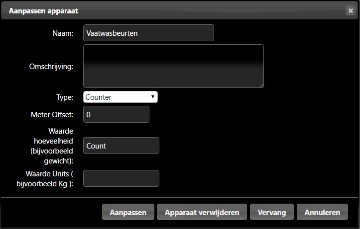

I mean, are you using a normal counter or an incremental counter? See picture
- 2017-05-10 12_59_11-Clipboard.jpg (11.17 KiB) Viewed 2456 times
