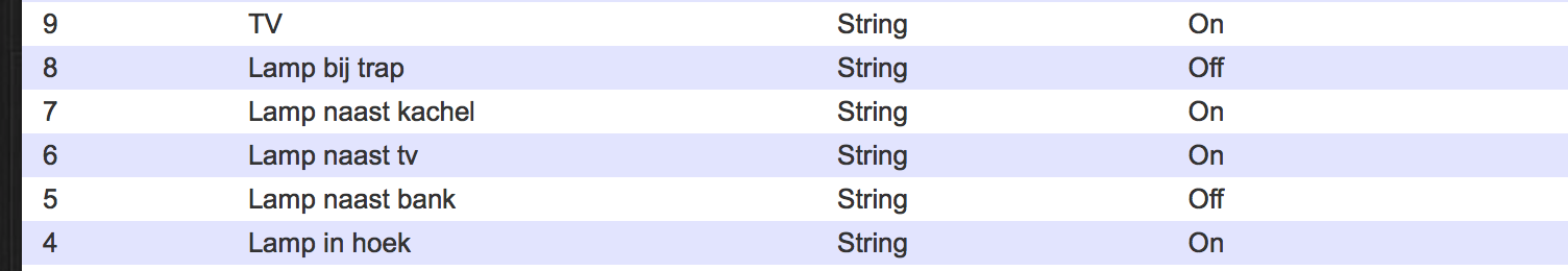

gerard76
Posts: 53
Joined: Wednesday 22 March 2017 9:13
Domoticz version: 3.8153
Re: Improve 433Mhz reliability
Post by gerard76 »
user variables example
Screen Shot 2017-04-02 at 21.53.09.png (54.57 KiB) Viewed 5728 times
Derik
Posts: 1605
Post by Derik »
mm
Sorry for my dombo questions..
Only why 1 device on and the other off?

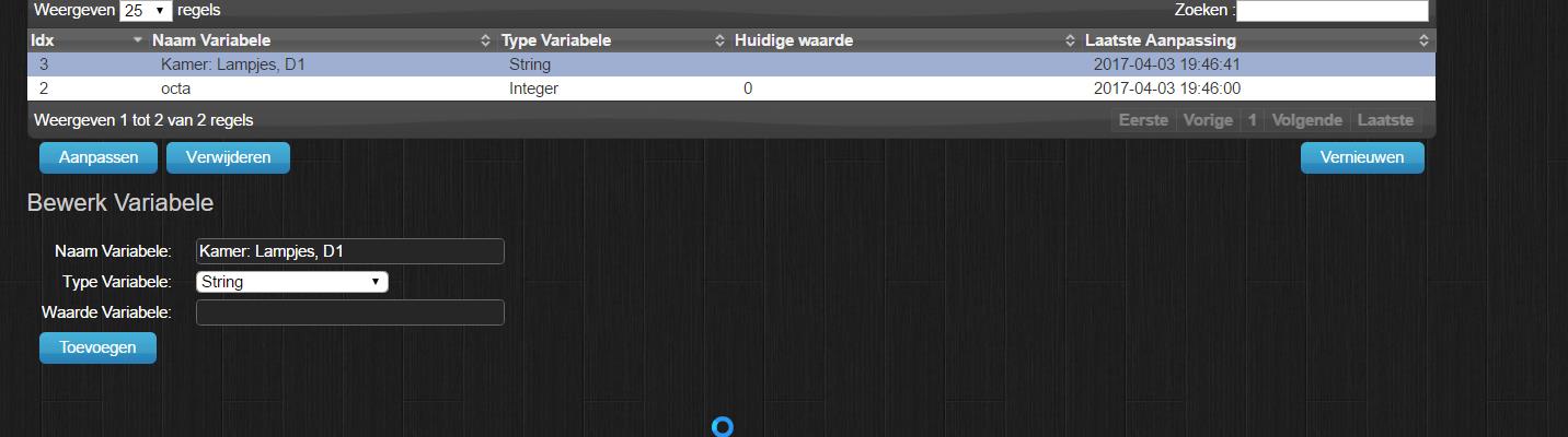

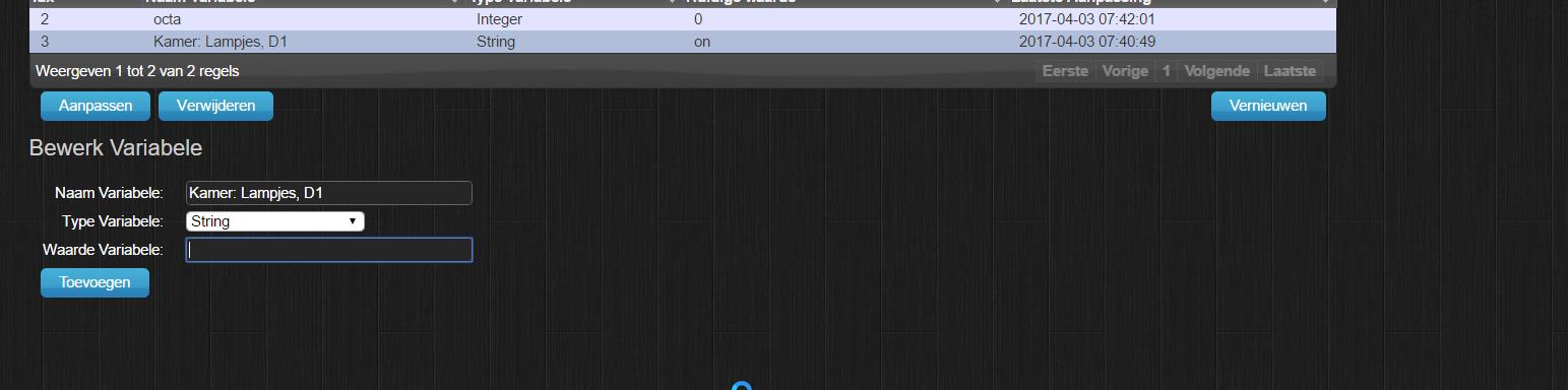

Posts: 1605
Post by Derik »
mm
Got an error:
2017-04-03 19:48:00.876 Error: EventSystem: in Lua: Extra Schakeling Aan: [string "commandArray = {}..."]:5: bad argument #1 to 'pairs' (table expected, got nil)
This is my setting:
And:
Looks there is something wrong
