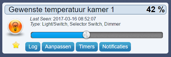

On my dashboard I want to have a slider to give in the desirable temperature. In that room I want to have a wireless temperature sensor. In a script I want to compare the desirable temperature with the measured temperature. The outcome of this gives a signal to a wireless relais board that switch a actuator on a floor heating distributer. I want to do this low cost, so no expensive thermostate or control box. Just a temperature sensor like DHT22, a ESP8266 Wifi board, a relais board and so on.
In Domoticz I made a slider.
How can I change the lowest value, the highest value and the startup value? Let say: the slider totally to the left is 10 ’C, the slider totally to the right is 30 ‘C.
How can I change the % symbol into ‘C symbol?
How do I read out the value of the slider?
Please an answer in beginners language.

I think the wiki is our beginners guide - which as such can and should be improved in various ways (kept up-to-date at least). But also in its current form it serves as a good starting point also for beginners, e.g. https://www.domoticz.com/wiki/Events#Lu ... _Interface
For you specific questions, I'm afraid these aren't to Lua in any way:
They are attributes fixed to the user interface and unfortunately not something you can change, with or without scripting. As for the last question (and something that solves also the two questions above), I think you are actually looking for a virtual thermostat device. I don't use any myself but there should be a lot of threads about it already. And as for the "beginners guide", I hope this helps a bit: https://www.domoticz.com/wiki/Thermostat_control But note, there might be some outdated parts, e.g.
 if (devicechanged[sonde]) then
         local temperature = devicechanged[string.format('%s_Temperature', sonde)]
I think this can be just:
 if devicechanged[sonde..'_Temperature'] then
