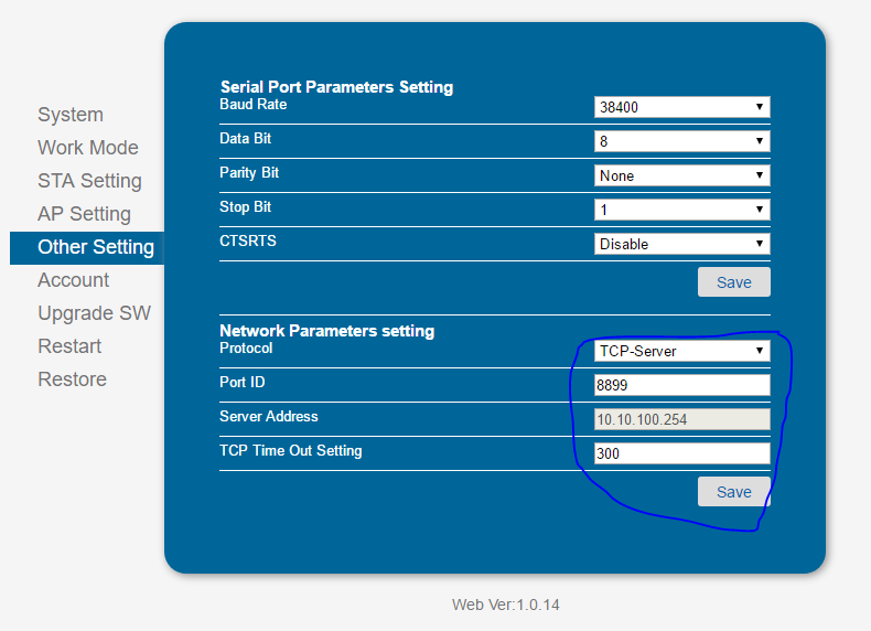

Hi, some more information..
As i cancelled dyndns, it didnt have effect on incoming connections. I had a feeling that this all started when i bought MiLight bridge and some bulbs..
Why do MiLight bridge have this in settings:
IP locations databases
Country Code	Country	Region	City	Latitude	Longitude	Last update
IP2Location	-		-	-	0	0	2017-01-16
MaxMind	US	United States	-	Durham	35.994	-78.8986	2017-01-16
It can be changed in AP settings :
Smartthings
