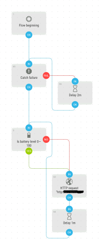

I read through several topics in the forum and found a simple solution to send battery information from Android to Domoticz. I use Automate on Android to get the data and create the json url. You can download the Flow from the Automate community Flow library. It is named: Battery level reporting tool for Domoticz. The battery level is sent over json like this: ../json.htm?type=command¶m=udevice&idx=92&svalue=55.1
In Domoticz I created a dummy percentage sensor. The ID of the sensor is set in the Automate flow as well as the url and the ssid of the wifi.

I'm using this Automate flow;
This is working great for about an year now. Based on "Android AccuBattery" the battery of my OnePlus 3t only lost 100mAh(~5%) of capacity
Where my previous Nexus5 lost >10% after 1 year.
Also on safety its great; No charging Lithium device in the house while sleeping
http://www.domoticz.com/forum/viewtopic ... 20#p156694
Would be great if its implemented into the Android app and Domoticz itself.
"Catch error?" >No> Loop every 1 minutes > Get BatteryLevel > Put BatteryLevel in Variable > Post the Automate Variable to an Domoticz UserVariable.
"Catch error?" >Yes> Delay 2 min.
