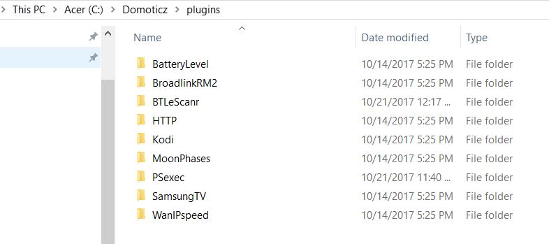

I don’t have a “plugins” directory under my Domoticz directory (under Program Files). Maybe something went wrong installing Python.
I will try to reinstall Python, with your link in an earlier post.
