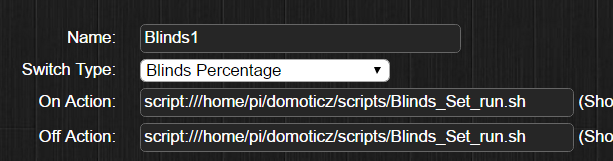

Each dimmer has these lines for action:
And the Blinds_Set_run.sh script contains the following code:

I have chosen to use an script in between like this to be able to check whether the actual action script is already running avoiding to run it multiple times and to end the event trigger immediately avoiding "hanging"the domoticz event system while the blinds are changing their angle.
You need to update the commands in the script with the correct IDX numbers and devicenames.
The shelled Blinds_Set.sh scripts will check the current status of the dimmer and compare that with the last saved value. In case they differ the servos will be activated in small steps so they slowly change.
