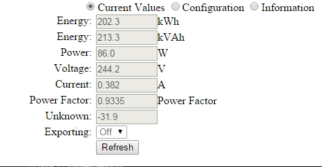

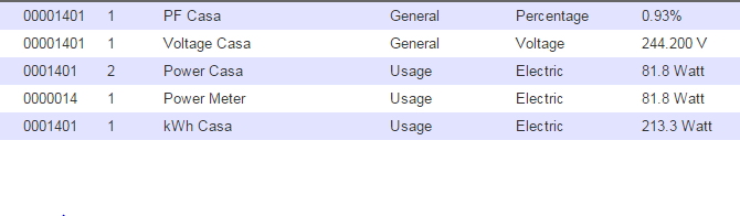

I have this qubino smart meter and I have a problem. In Open Z-wave Control Panel I have all the values correct. Then if I look to the domoticz devices I don't have the the KWh value and I have the KVAh but expressed as W. please see the attached pictures.

nvicente wrote:I have this qubino smart meter and I have a problem. In Open Z-wave Control Panel I have all the values correct. Then if I look to the domoticz devices I don't have the the KWh value and I have the KVAh but expressed as W. please see the attached pictures.
best regards.
As you can see from the attached screenshot, in the OZW control panel, the information are present and correct, like for yours:
Qubino detail 1.PNG (281.46 KiB) Viewed 7812 times
But the device appeare like "Unknown" and in the Log output screen there are errors reported by the Node005, the Smart Meter.
