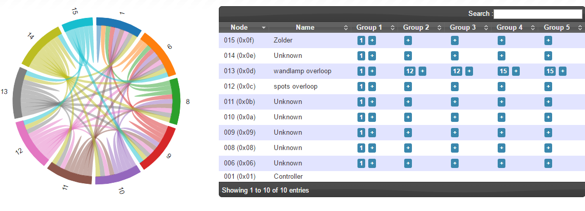

I want to use a S2 button of one dimmer to turn on another dimmer. To achieve this I've put the second dimmer (node 15) in group 4 and 5 of the first one (node 13). But pressing the s2 button does not turn on the other light.
I've attached a screenshot of the groups. Is this not correct?

I'm sure you sorted this by now but for future reference, it's supposed to be the other way around. Your remote dimmer needs to have the id of the dimmer to which the light is connected in its groups 4 + 5.
