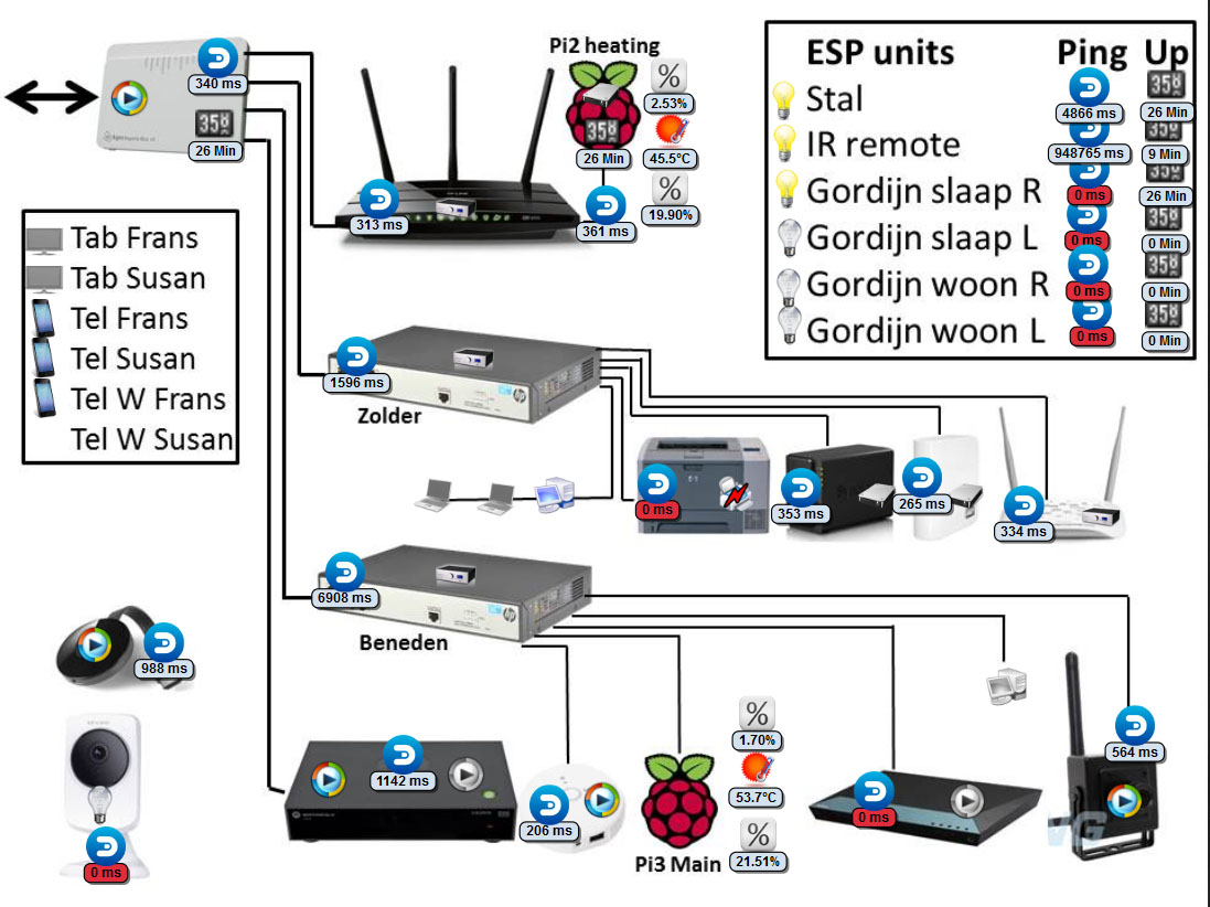

I have combined a few scripts in Domoticz to monitor my network performance that I like to share.
This is the floorplan with all my network vitals displayed in one quick overview
Checking if network devices are online
I have multiple scripts runing, first the ARP scan to detect if devices are on or off, this way you don't have to know the IP of the devices in your network and can use a DHCP server.
This script is based on this topic on domoticz forum: viewtopic.php?f=23&t=5256

-- create a table to store device information
devicetable = {}
-- Device 1
device = 1
devicetable["name" .. device] = 'KPN Modem'           -- exact name of the device to be checked for on time
devicetable["timer" .. device] = 'Uptime KPN Modem'     -- exact name of the counter created for this device
devicetable["ID" .. device] = 368                       -- idx of the counter created for this device
-- Device 2
device=2
devicetable["name" .. device] = 'Pi2Heating'           -- exact name of the device to be checked for on time
devicetable["timer" .. device] = 'Uptime Pi2Heating'     -- exact name of the counter created for this device
devicetable["ID" .. device] = 369                      -- idx of the counter created for this device
-- Device 3
device=3
devicetable["name" .. device] = 'ESPIRAlive'           -- exact name of the device to be checked for on time
devicetable["timer" .. device] = 'Uptime IR remote'     -- exact name of the counter created for this device
devicetable["ID" .. device] = 370                       -- idx of the counter created for this device
-- Device 4
device=4
devicetable["name" .. device] = 'ESPStalletjeAlive'           -- exact name of the device to be checked for on time
devicetable["timer" .. device] = 'Uptime Schuur'     -- exact name of the counter created for this device
devicetable["ID" .. device] = 371                       -- idx of the counter created for this device
-- Device 5
device=5
devicetable["name" .. device] = 'ESPGSRAlive'           -- exact name of the device to be checked for on time
devicetable["timer" .. device] = 'Uptime ESP GSR'     -- exact name of the counter created for this device
devicetable["ID" .. device] = 372                       -- idx of the counter created for this device
-- Device 6
device=6
devicetable["name" .. device] = 'ESPGSLAlive'           -- exact name of the device to be checked for on time
devicetable["timer" .. device] = 'Uptime ESP GSL'     -- exact name of the counter created for this device
devicetable["ID" .. device] = 373                       -- idx of the counter created for this device
-- Device 7
device=7
devicetable["name" .. device] = 'ESPGWRAlive'           -- exact name of the device to be checked for on time
devicetable["timer" .. device] = 'Uptime ESP GWR'     -- exact name of the counter created for this device
devicetable["ID" .. device] = 374                       -- idx of the counter created for this device
-- Device 8
device=8
devicetable["name" .. device] = 'ESPGWLAlive'           -- exact name of the device to be checked for on time
devicetable["ID" .. device] = 375                       -- idx of the counter created for this device
for i=1,devicecount do
    if otherdevices[devicetable["name" .. i]] == 'On' then
	    TotalMinutesUp = tonumber(otherdevices_svalues[devicetable["timer" .. i]])
    	TotalMinutesUpNew = TotalMinutesUp + 1
    	TimerID = tonumber(devicetable["ID" .. i])
            execcommandUp="sudo /home/pi/domoticz/scripts/bash/SetCounter.sh "..TimerID.." "..TotalMinutesUpNew.." &"
            os.execute(execcommandUp)
        if PRINT_MODE == true then
            print('Device sequence: ' .. i)
            print('Device name detected On :' .. devicetable["name" .. i])
            print('Device name On timer :' .. devicetable["timer" .. i])
            print('Device ID timer counter :' .. TimerID)
		    print('Previous Uptime: ' .. TotalMinutesOn)
		    print('New Uptime: ' .. TotalMinutesOnNew)
    elseif otherdevices[devicetable["name" .. i]] == 'Off' then
            print('Device detected Off: ' .. devicetable["name" .. i])
            print('Resetting uptimer to 0')
            Reset=0
            execcommandUp="sudo /home/pi/domoticz/scripts/bash/SetCounter.sh "..TimerID.." "..Reset.." &"
            print('Device ERROR: ' .. devicetable["name" .. i])
return commandArray
Since I want to update multiple customer counters, i need to do this through a bash script, since lua in domoticz will only update the last custom device called out to.
    #!/bin/bash
    IDX=$1
    COUNT=$2
	curl "http://127.0.0.1:8080/json.htm?type=command&param=udevice&idx=$IDX&nvalue=0&svalue=$COUNT"
Ontime tracking of devices in my network
Last I want to monitor ontime for some devices, just to see how often the phones, TV and so on is switched on... just because I can...
-- this script is to detect on time of devices in domoticz
-- based on the script of mvzut that can be found here on the forum
-- https://www.domoticz.com/forum/viewtopic.php?f=38
-- this has to be a time based lua script in domoticz (as device script this will not work
-- for every device to monitor a counter has to be created as virtual devicecount
-- Create an incremental counter using the Dummy hardware component (first add this component if you haven't already done so before, using Setup>Hardware).
-- Then go to the Utility section, change the type of your new counter from Energy to Counter, and fill in the Value Quantity (e.g. "On time") and Value Units ("Minutes").
-- Check the Device ID (idx) that is given to the new counter device.
-- this script can be run in combination with an ping, bluetooth scan or an arp scan what is in some cases more reliable
    -- ping: https://www.domoticz.com/wiki/Presence_detection
    -- bluetooth: https://www.domoticz.com/wiki/Presence_detection_(Bluetooth_4.0_Low_energy_Beacon)
    -- arp scan: https://www.domoticz.com/forum/viewtopic.php?f=23&t=5256
-- define general script values
devicecount = 11                     -- number of deviced to be cheked by the script for on time
PRINT_MODE = false					-- when true wil print output to log and send notifications
devicetable = {}
-- Device 1
device = 1
devicetable["name" .. device] = 'FransMobiel'           -- exact name of the device to be checked for on time
devicetable["timer" .. device] = 'FransMobielTimer'     -- exact name of the counter created for this device
devicetable["ID" .. device] = 237                       -- idx of the counter created for this device
-- Device 2
device=2
devicetable["name" .. device] = 'SusanMobiel'           -- exact name of the device to be checked for on time
devicetable["timer" .. device] = 'SusanMobielTimer'     -- exact name of the counter created for this device
devicetable["ID" .. device] = 238                       -- idx of the counter created for this device
-- Device 3
device=3
devicetable["name" .. device] = 'FransTablet'           -- exact name of the device to be checked for on time
devicetable["timer" .. device] = 'FransTabletTimer'     -- exact name of the counter created for this device
devicetable["ID" .. device] = 239                       -- idx of the counter created for this device
-- Device 4
device=4
devicetable["name" .. device] = 'SusanTablet'           -- exact name of the device to be checked for on time
devicetable["timer" .. device] = 'SusanTabletTimer'     -- exact name of the counter created for this device
devicetable["ID" .. device] = 240                       -- idx of the counter created for this device
-- Device 5
device=5
devicetable["name" .. device] = 'FransPC'           -- exact name of the device to be checked for on time
devicetable["timer" .. device] = 'FransPCTimer'     -- exact name of the counter created for this device
devicetable["ID" .. device] = 241                       -- idx of the counter created for this device
-- Device 6
device=6
devicetable["name" .. device] = 'SusanPC'           -- exact name of the device to be checked for on time
devicetable["timer" .. device] = 'SusanPCTimer'     -- exact name of the counter created for this device
devicetable["ID" .. device] = 242                       -- idx of the counter created for this device
-- Device 7
device=7
devicetable["name" .. device] = 'SonyBlueRay'           -- exact name of the device to be checked for on time
devicetable["timer" .. device] = 'SonyBlueRayTimer'     -- exact name of the counter created for this device
devicetable["ID" .. device] = 243                       -- idx of the counter created for this device
-- Device 8
device=8
devicetable["name" .. device] = 'ITV receiver'           -- exact name of the device to be checked for on time
devicetable["timer" .. device] = 'ITV receiverTimer'     -- exact name of the counter created for this device
devicetable["ID" .. device] = 244                       -- idx of the counter created for this device
-- Device 9
device=9
devicetable["name" .. device] = 'ASM-Lan'           -- exact name of the device to be checked for on time
devicetable["timer" .. device] = 'ASM-LanTimer'     -- exact name of the counter created for this device
devicetable["ID" .. device] = 245                       -- idx of the counter created for this device
-- Device 10
device=10
devicetable["name" .. device] = 'ASM-Wifi'           -- exact name of the device to be checked for on time
devicetable["timer" .. device] = 'ASM-WifiTimer'     -- exact name of the counter created for this device
devicetable["ID" .. device] = 246                       -- idx of the counter created for this device
-- Device 11
device=11
devicetable["name" .. device] = 'Chromecast'           -- exact name of the device to be checked for on time
devicetable["timer" .. device] = 'ChromecastTimer'     -- exact name of the counter created for this device
devicetable["ID" .. device] = 247                       -- idx of the counter created for this device
	    TotalMinutesOn = tonumber(otherdevices_svalues[devicetable["timer" .. i]])
    	TotalMinutesOnNew = TotalMinutesOn + 1
--	    commandArray['UpdateDevice'] =  TimerID .. '|0|' .. tonumber(TotalMinutesOnNew)
            execcommandOn="sudo /home/pi/domoticz/scripts/bash/SetCounter.sh "..TimerID.." "..TotalMinutesOnNew.." &"
            os.execute(execcommandOn)
		    print('Previous on time: ' .. TotalMinutesOn)
		    print('New on time: ' .. TotalMinutesOnNew)
            print('No update of the timer needed')
return commandArray
Reboot scripts
For the domoticz servers I use them to do a crosscheck if domoticz is still runing and if not reboot the server, since just restarting domoticz is not always working. I do this with a time based lua script on both servers
        print ("Checking if heating Pi 2 is online")
        execcommand="sudo /home/pi/domoticz/scripts/bash/CheckOnline.sh"
        os.execute(execcommand)
return commandArray
calling out for the following bash script
#!/bin/sh
# check domoticz
status=`curl -s -i -H "Accept: application/json" "http://192.168.2.141:8080/json.htm?type=devices&rid=1" | grep "status"| awk -F: '{print $2}'|sed 's/,//'| sed 's/\"//g'`
if [ $status ]
then
echo "Domoticz draait nog"
echo "Domoticz draait niet meer, rebooting server"
curl "http://127.0.0.1:8080/json.htm?type=command&param=switchlight&idx=146&switchcmd=On"
sshpass -p 'xxxxxxxx' ssh [email protected] 'sudo reboot'
fi
sshpass you have to login manually first to accept the key presented, but after that it will run from the script
The script switches a virtual switch to let me know it rebooted the other server, in the startup script of the other server it sends an off command again so I can see in the logging that the reboot was successful
emme
