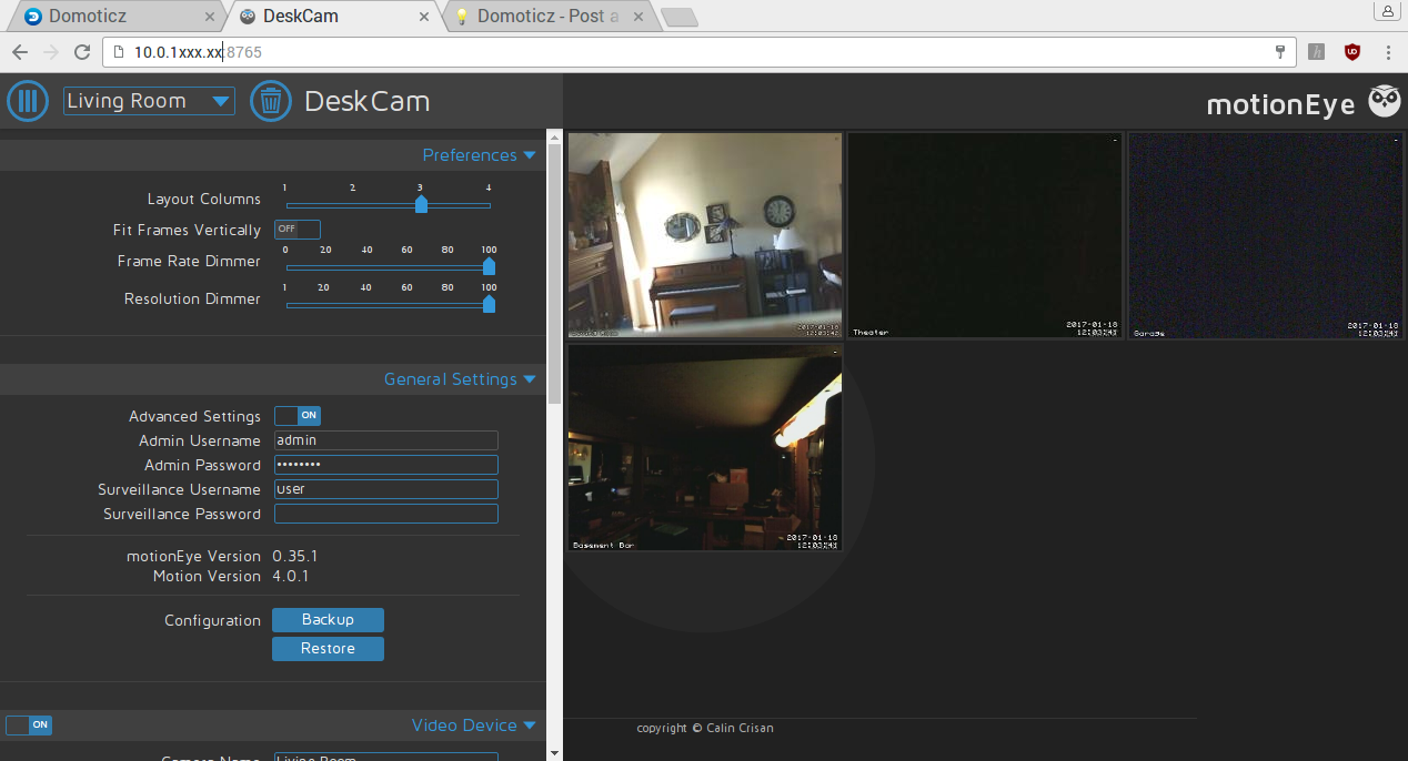

I am not sure if it possible to get my current setup working in Domoticz but I am half way there and looking for some assistance. I have looked to the camera wiki page and it has allowed some success.
My current setup has several USB camera attached to their own RPI and an RPi running MotionEye as the main controller. This works great.
Now I'd like to see about getting the cameras added to Domoticz. I can access each camera's direct feed in the browser by doing the following.
Live feed: http://10.0.xxx.xx:xxxx
List image: http://10.0.xxx.xx:xxxxx/picture/1/current/
Testing the live feed link in the More Options >> Cameras does show the feed when I test it during setup.
Back on the Camera page the image to the far left is broken. If I right click and look at the locaion it is the Domoitcz server with /camsnapshot.jpg?idx=1 after it. Clciking on the web cam icon brings up the live feed overlay window but the stream loads as a broken image.
Is this the correct way to get my setup working in Domoticz or is it just not possible with my setup?
Thank you.

In Domoticz you should not add the http://10.0.x.x in the ImageURL box, only this:
picture/1/current/

heggink wrote: Sunday 04 February 2018 21:49 Anyone ever got this to work?
Yes. I did.
You should add a different URL:
picture/1/current/?_username=admin&_signature=[whatever your signature is]
You can get your exact URL in Video Streaming - Snapshot URL in the motionEye settings. Make sure there is no "/" in front of the image URL.
Works fine in the latest Domoticz.

I have solved it for me. Had the same issue.
In Motioneye added a user with no password. (only view rights)
Then i made the configuration as mentioned with: picture/1/current/
The standard port = 8765
works for me.
