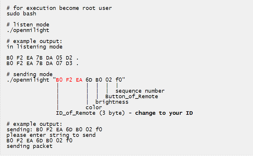

Well,..offcourse i'm not an expert but I do have openlight software using the RF24 libraries running. I can start openlight and put it in listeningn and sending mode. I added a screenshot. You can find the whole article here
http://torsten-traenkner.de/wissen/smar ... ilight.php
I was thinking if I create dummy switch intiating a script with the command I might be in the ballpark but maybe I'm wrong....
I just ordered the radiochips and the remote from milight. I need the remote to identify the pairing link id and I should be able to do this with the raspberry with openmilihgt in listening mode.
