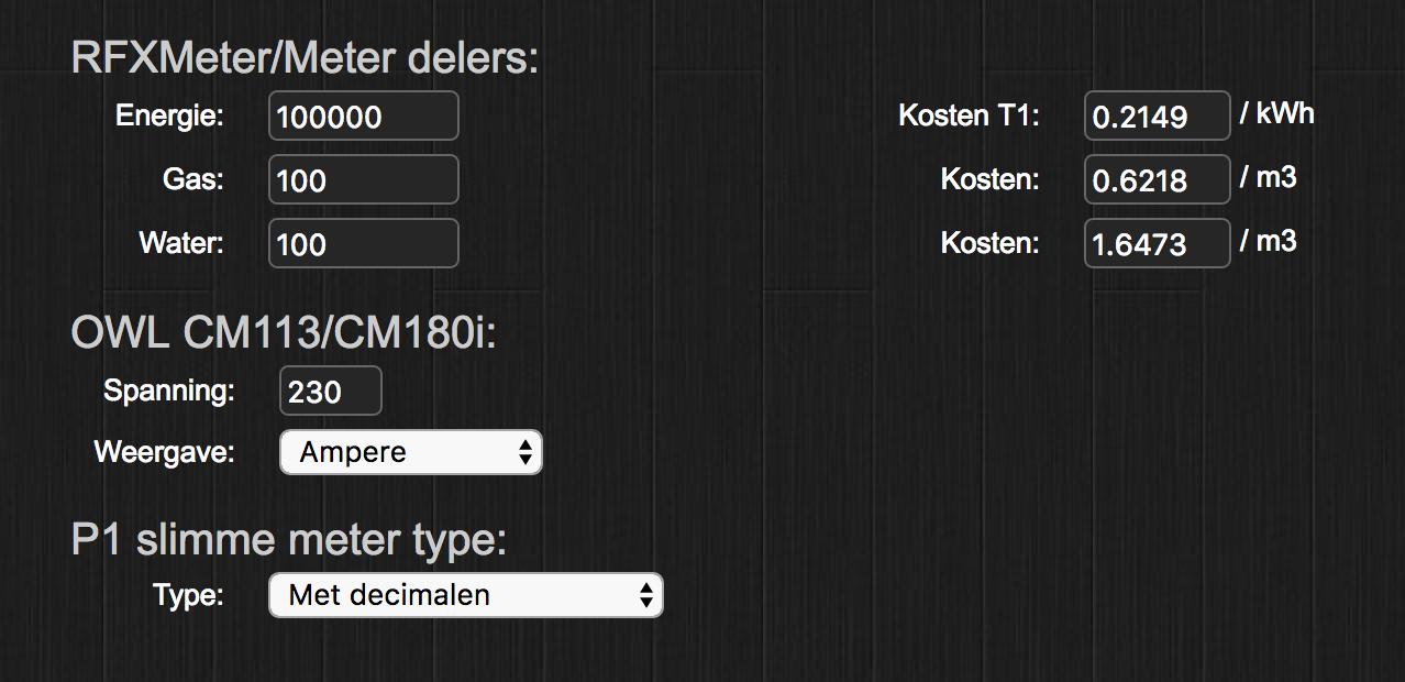

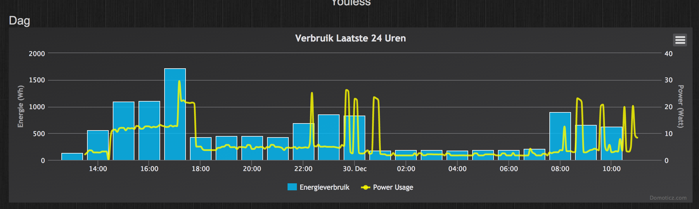

Had some trouble setting up my Youless... (no daily usage value, but Siewert308SW helped me out :-))
I changed the RFXMeter/Meter dividers... (for energy from 1000 to 100000). That changed the KwH value to the right numbers... But it also changes the Power usage in Watts (which is a factor 100 lower now).The KwH value on the left axes are right, but the actual Power usage in Watt not.
Schermafdruk 2016-12-30 11.07.10.png (350.84 KiB) Viewed 580 times
Schermafdruk 2016-12-30 11.01.14.png (339.37 KiB) Viewed 580 times
Any tips?

Tried to change back the 100000 to 1000 as it should be.
100000 is a way to high number as your meter has a 1000 output

When I change it back, the Kwh reading is messed up again.
