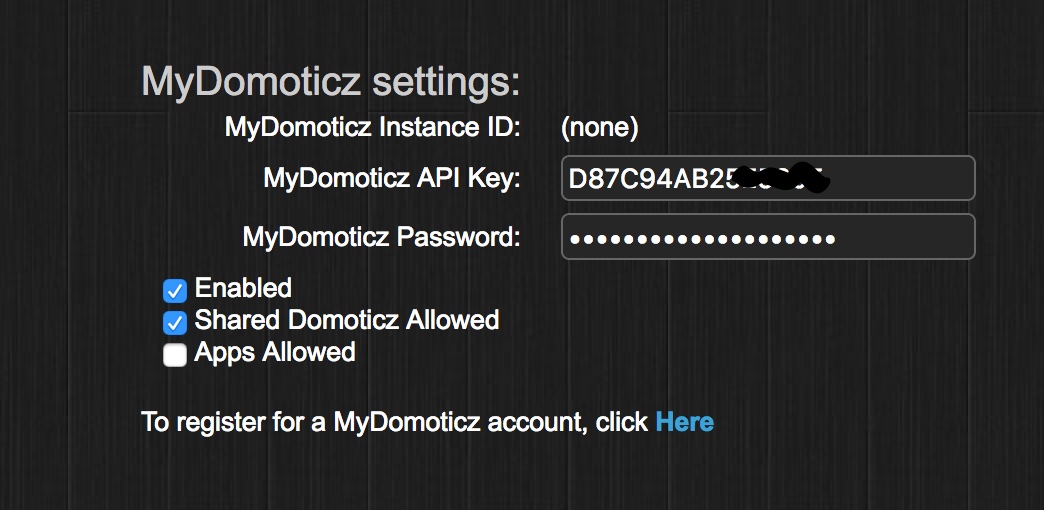

I have the same problem, i'm new to this is it some mistake?
2016-12-10 19:22:30.192 Proxymanager started.
2016-12-10 19:22:30.203 Accepting shared server connections via MyDomotiz (see settings menu).
2016-12-10 19:22:30.230 Active notification subsystems: (0/12)
2016-12-10 19:22:45.237 Error: PROXY: StartThread(): Exception: resolve: Host not found (authoritative)
I have changed the password but still no luck?
I am running domoticz on a RaspberryPi Zero and accessing from my macbook pro using firefox.
Screen Shot 2016-12-10 at 19.26.jpg (116.91 KiB) Viewed 4982 times
