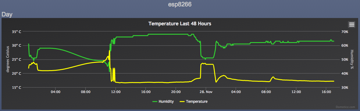

I see the temp, humidity & barometer values properly updated on ESP8266 and sent to my Raspberry over JSON.
I also see on Domoticz, the temperature graphic is properly recording the temp & humidity values over the time:

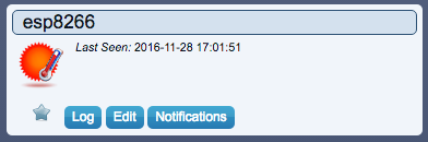

All is good so far but the issue is with the temperature widget itself not providing the latest temp & humidity values (on the top-right side of the widget) :
Screen Shot 2016-11-28 at 17.03.00.png (21.29 KiB) Viewed 1442 times
Do you know what shall be done to fix it ?

Hello guys,
I just figured out my issue. It was due to my virtual sensor not setup properly. My BME280 sensor on ESP8266 gives temperature+humidity+barometer values and JSON data sent by ESPEasy provides these 3 values to Domoticz whereas I made a virtual sensor temp+humidity without barometer.
I changed the virtual sensor to temp+hum+bar in domoticz and it fixed my issue. :D
Thank to @gizmocuz for his support on this.
