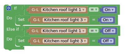

Re: zwave-how to control wall-plug with domoticz and physical switch
I did a Blockly script, to let switch1 control switch3. they are both zwave switches, Fibaro relay something.
