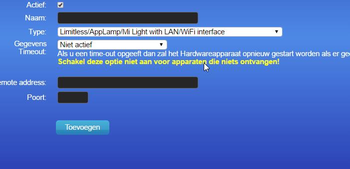

I have the similar setup. Do you mind me asking how you control different types of bulbs? I have to switch between RGBW and White in the settings of Limitless/Milight in order to make different switches to work. Otherwise it is either RGBW or White switch works. This is extremely cumbersome so I am trying to find another way...Derik wrote:yes...

I think you need to add the same hardware twice, for one you use the RGB(W) setup and for the other White. Not tested as I currently have only one type of lights.alexsh1 wrote: I have the similar setup. Do you mind me asking how you control different types of bulbs? I have to switch between RGBW and White in the settings of Limitless/Milight in order to make different switches to work. Otherwise it is either RGBW or White switch works. This is extremely cumbersome so I am trying to find another way...

that's what I did. However, with it is either RGBW or W works - I have to manually toggle it in the settingsNautilus wrote:I think you need to add the same hardware twice, for one you use the RGB(W) setup and for the other White. Not tested as I currently have only one type of lights.alexsh1 wrote: I have the similar setup. Do you mind me asking how you control different types of bulbs? I have to switch between RGBW and White in the settings of Limitless/Milight in order to make different switches to work. Otherwise it is either RGBW or White switch works. This is extremely cumbersome so I am trying to find another way...

Ok, as mentioned I only have one type of bulbs so I just assumed it would work this way. I guess you named them differently (probably Domoticz does not allow hardware with same name) so not too many options to try here... The wifi bridges are quite cheap nowadays so one option is to by an additional bridge and use different bridges to control different types of bulbs.alexsh1 wrote: that's what I did. However, with it is either RGBW or W works - I have to manually toggle it in the settings
