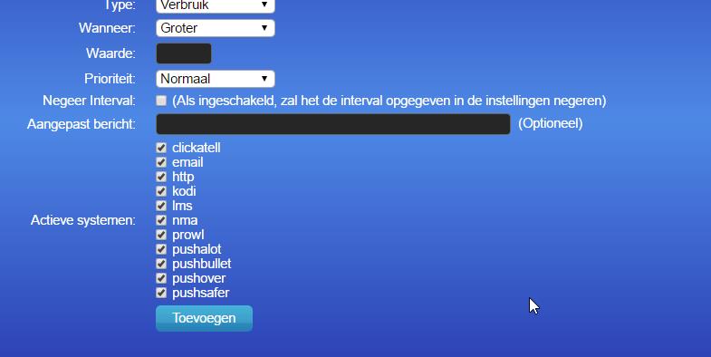

Anyone knows why
(devicechanged['Scene:...]) is not working in LUA scripts?
astrapowerrr
Posts: 141
Joined: Tuesday 31 January 2017 20:34
Re: notification when a scene start
Post by astrapowerrr »
I just updated to the beta version and now when any scene is started I get notification.
For example: I have set 2 notification 1 for opening and closing air ventilation and one if pond temp gets above 10 degrees. Both working fine!!
But now when I use the scene I’m home, or good night, or close curtains, etc...
The notification says my pond is above 10 degrees and it gives a notification of the air vent position(closed or open at the time).
So when I’m not at home and with sunset my curtains are closing(scene) I get notification my airvent is open. :oops: :?
So it notifies the status, but I want to be notified when it changes....
Someone familiar with this?
