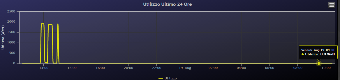

I have the Z-Wave GreenWave PowerNode 1 (http://www.allcontroll.no/produkt/smartkontakt/) and it works very good, exception for one problem
occasionally lose the signal (I think), the background becomes red (screenshot.308.png).
And in the measures I haven't details each five minutes but, for example I lose the measures of 21:30 o 9:30 (screenshot.309.png).
If I turn on the node from the list of switches, back with white background.
Do you know if after a specified time automatically goes into standby mode or if there is a problem?

The Greenwave nodes like polling. Do you have it enabled for that node? Maybe with a very long polling interval, like ex 300 seconds.

I have 3 powernodes 1, they all stop working after some time, if I do not poll them. I get gaps between readings, eventhou the power is changing, and after a couple of days they start the blink green and will not connect unless I restart domoticz (or the z-wave usb controller hardware)... bringing a cascade effect on the other sensors connected to the usb controller through the powernode...
With polling, they work perfectly... and all the other sensors keep working...

with polling works, however I seen that the spleepeng is a very intelligent management system, when the greenwave receives a command from the server, or a change in consumption from the appliance connected, is reactivated.
