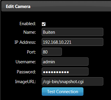

When I set this settings in Domoticz it doesn’t work. This are my settings in Domoticz:
When I click on the button Snapshot I get a jpg file from 1kB. If I open this file with Notepad++ I see this:
<html><body><h1>404 Not Found</h1></body></html>
Why this is not working?

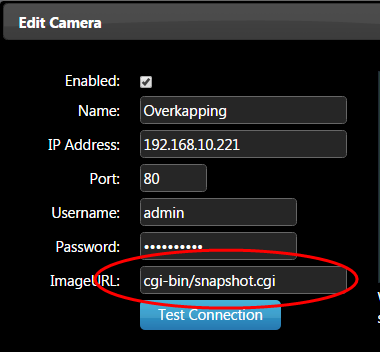

After a long time of testing and searching on the internet I had no success to getting this to work.
It works now :-)
I needed to remove the first slash in the ImageURL. I have two systems here and it works now on both systems.
I have no idea why.
