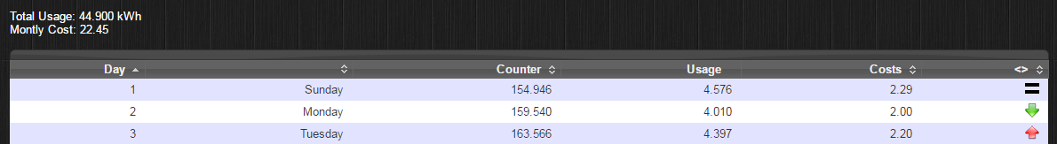

Now it's only available under device report.
How did you achieve that in costum sensor?
My goal is to reset cost data every two months - I got pricing from my energy supplier every two months.
