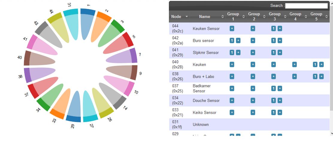

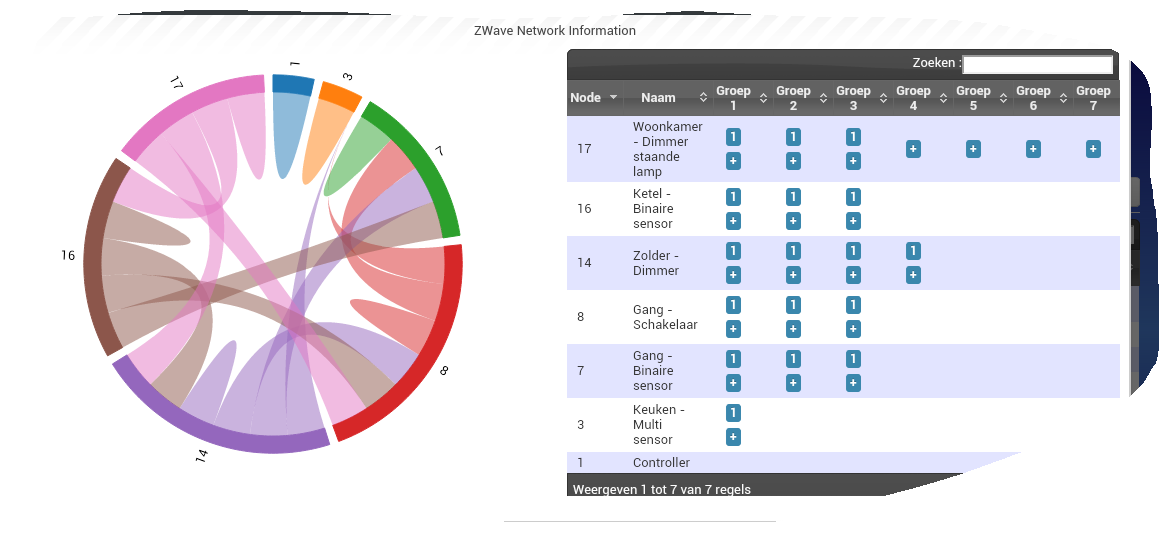

doesn't this look tooooooo complicated ?
have I done something wrong ?
do I need to adjust some settings ?
How can I simplify my network ?
I'm worried about it ...
- screen.JPG (92.72 KiB) Viewed 7657 times

What's the problem? What's too complicated?
Looks pretty normal, wait until you have some more devices, then you see nothing anymore.

That is what one calls a MESH network

I thought there were too many connections going on, making the network unstable maybe ?
... that's why I was worried, but apparently this is normal and I shouldn't worry about it ?

As said, zwave creates a mesh network with alternative routes to route the information back to the controller. This should make it more stable then with single routes. Maybe a nice read to understand the basics: http://www.vesternet.com/resources/tech ... e-networks

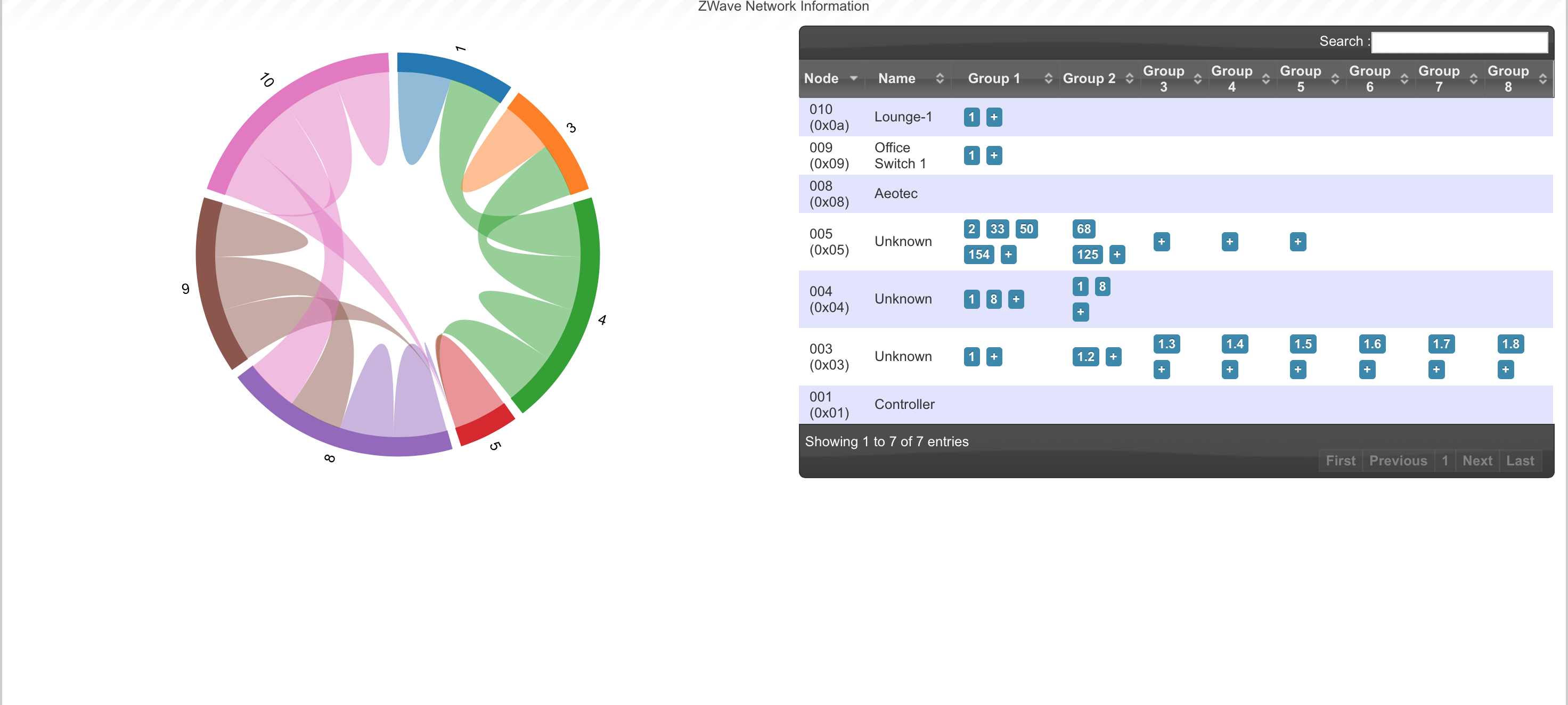

Yeah... I think there's an issue somewhere. Because I have two controllers and 6 nodes. The two controllers are on separate raspberry pi-2's. The first controller (RaBerry) see this...
The second controller (Aeotec G5 USB) sees this...
Given that it's one network. Both graphs SHOULD look the same. But they don't... They also don't quite match the node status. For example the RaZBerry (Node001) graph shows that the network is almost in two parts. With Node005 acting as the relay between one side and the other. Yet the RaZBerry more often than not shows Node005 as DEAD. The second controller (Node004) on the other hand can see Node005 fine...
Very strange... I'm not sure I understand why the graphs and device comms lists should look so different on the same network.

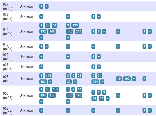

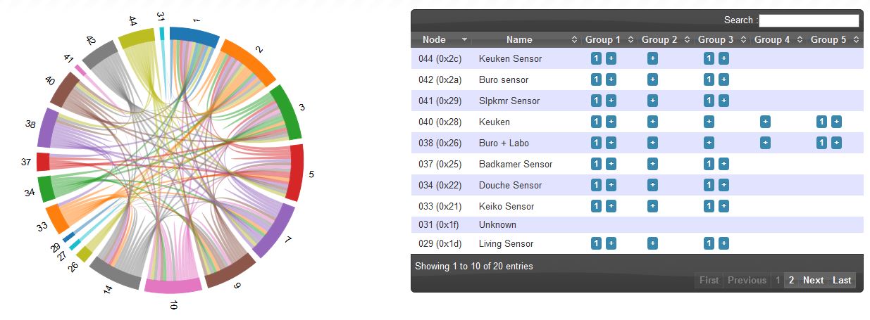

This morning Domoticz asked me to update ... I agreed
This is what I discover this evening ...
suddenly, all by itself !
why ? how ?
why ? how ?
- zwave.JPG (69.52 KiB) Viewed 7219 times
RasPi2 - Aeotec Z-Stick S2 - Fibaro multisensors - Fibaro RGBW dimmers - ETH08 relais boards

You can use Zwave Control Panel to see the topology as a table, perhaps it's easier than this beatiful and coloured picture.

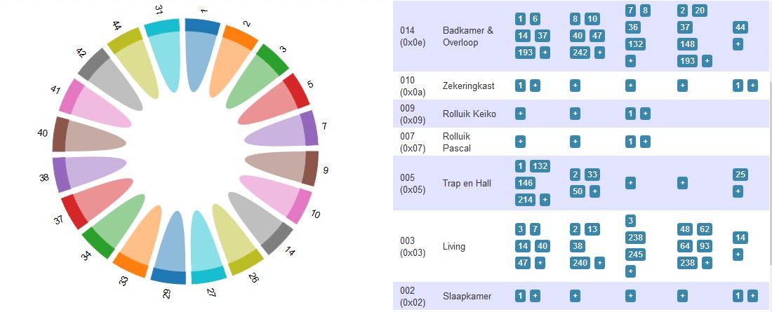

my question is : how can it automatically go from this
to this
only by updating Domoticz ?
NOTHING has changed to the controllers, dimmers, sensors ... to the network itself
how do these connections suddenly appear in the group list and where are all the connections in the graph view ?
behavior in the hous was crazy ... garage licht made heater turning on and all kinds of crazy connections !
I cleaned it up (by removing all "weird" nodes from the groups) and now it looks like this ... everything seems to work, but still the pie-graph doesn't show any connections ... very weird

The group associations explain the weird behavior.
But why the links are all gone? I really can't say, I assume you waited for the screenshot until all nodes are queried aka blue settings button?
Yep, all nodes are there ... look !

And restart or network heal doesn't change anything?
pascalspits
- Posts: 88
- Joined: Tuesday 24 February 2015 16:14
- Location: Belgium

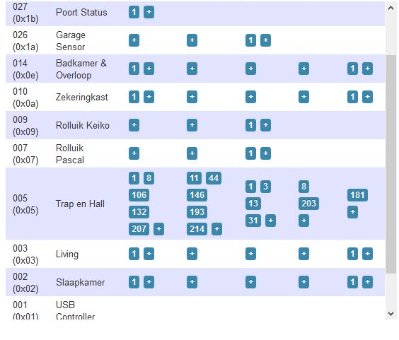

Re: Zwave network toooooo complicated ?
network heal froze/crashed the system, so I rebooted the Pi
after rebooting I check the network information and BOOM !
again it made a bunch of crazy connections all by itself ...
(by the way, this "trap en hall" is a RGBW dimmer from Fibaro)
what am I doing wrong ??

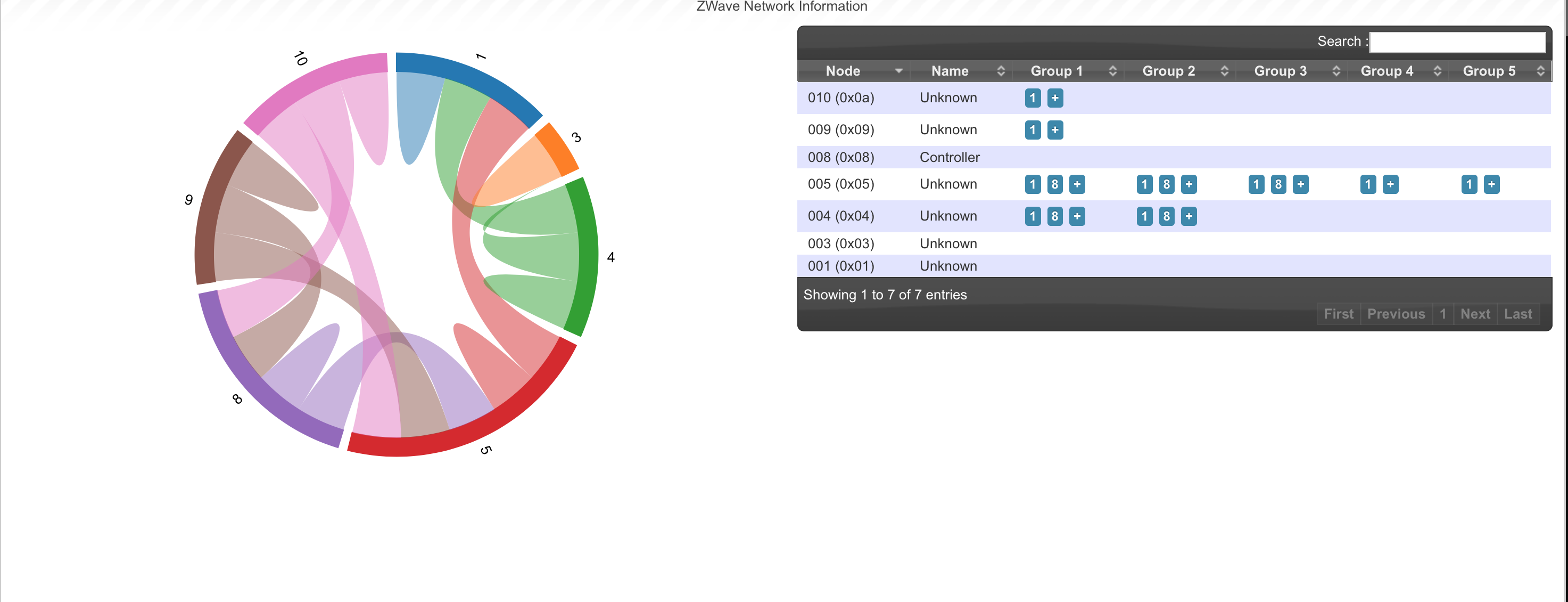

last few weeks again started to notice strange behaviour ... for example : bedroom blinds going up or down when switching on bathroom lights ... ?!
I did a soft reset controller and then these weird Zwave connections appeared again ...
this keeps puzzling me ... where do these crazy connections come from all by theirself ?!
What am I doing wrong here ?
