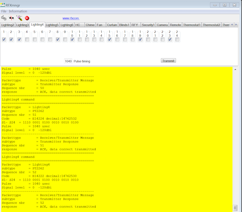

So, I have successfully paired the kingpin receiver in RFXmngr and transmitted these commands from RFXmngr.
Skärmavbild 2016-04-14 kl. 20.39.46.png (252.17 KiB) Viewed 3271 times
The screen from RFXmngr goes up and down, depending on the code I transmit.

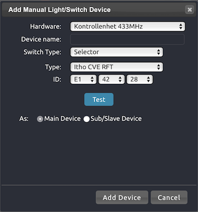

But.. can someone please help me to add the device in domoticz :/, tried to choose switches/manual light switch, and tried to select the right code and test it, no luck, guess I should have some blinds type switch type - right..?, how do I choose pulse timing 1040 :/, and which one is lightning4, thanks for any help!!!!

Did I miss some step in RFXmngr, all I did was pair my remote and try to transmit the commands..

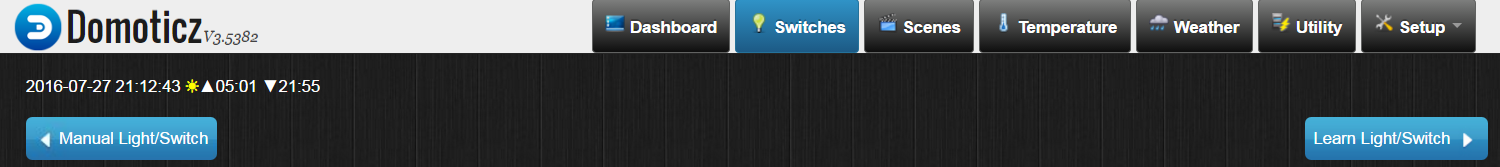

Have you tried learning the remote commands? I have a Mutibracket projector screen that also registerd as "lighting4" through rfxmanager.
Under the switch tab in Domoticz, hit the "learn light/switch" button, then press the remote button you want Domoticz to learn.
domoticz, learn switch.png (59.39 KiB) Viewed 3104 times

You cannot add a Lighting4 protocol manually. Someone made a patch, but it doesnt appear to have been submitted.
viewtopic.php?t=5367
Have you checked to see if you are using incompatible protocols in your RFXCom?
Like this for instance http://www.domoticz.com/forum/viewtopic ... 44&t=15070
