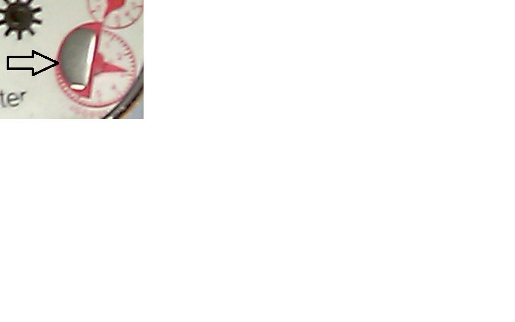

To add to the discussion on Reed or proximity - contact.
I have added a photo of a part of my watermeter with the metal element.
Are there any firm conclusions to be drawn from this photo?
Brgds
Cwavontuur
aka I must have done something wrong to blow up the component or it arrived busted.
Never mind.
Brgds
Cwavontuur

At least that's the same as mine! I tried my CNY70 sensor to detect the metal disc but the cny70 only does a good job at black/white detection. It served well measuring electricity until i had a smart meter installed with P1 cable to have the gas usage also monitored.
If the metal disc would be magnetic the reed contact proposed below would be the cheapest solution of all!
/paul
/paul

You could try with a small piece of iron hanging on sewing-thread to see if it moves as the meter is counting water.
If it is magnetic you vcan buy a reed switch http://www.produktinfo.conrad.com/daten ... _313_3.pdf or http://www.produktinfo.conrad.com/daten ... _10_VA.pdf

This morning held a little compass to the turning metal part but observed no reaction what so ever.
The specs mention magnet free communication interface.
specs http://www.elster.nl/downloads/V200V210 ... Engels.pdf
So I doubt the metal item is magnetic.
Brgds
cwavontuur
Brgds
cwavontuur

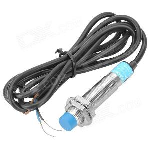

Today, to my surprise, the USD 7,99 metal sensor from China arrived by airmail (only took them 12 days!).
Luckily the specs are printed on the device because they differ way from the specs on the dx.com website.
This one has a three wire connection 6..36V DC and NPN (instead of 5~36V PNP) but also detects metal within 4mm.
It's an "OMOHON" device
(yes: sounds like ... see posts below).
Quickly hooked it up to a 5.4V supply. Because it has a LED on the back, detection is simply visible without connecting it up to the PiFace yet. The LED lits up faintly when metal is near and power consumption for the device itself is only 0,4mA.
Then the big test: will it detect the Elster disc? === IT DOES === !!
When pushing the sensor against the meter window a nice pulse is provided when the disc passes by.
At 12V DC it draws a mere 4 mA and the LED lits nicely. So probably the 5V from the raspberry will not be enough.
Next will be to build a construction which keeps the sensor in place and a small circuit to adjust the output to the PiFace levels.
...to be continued...
/paul

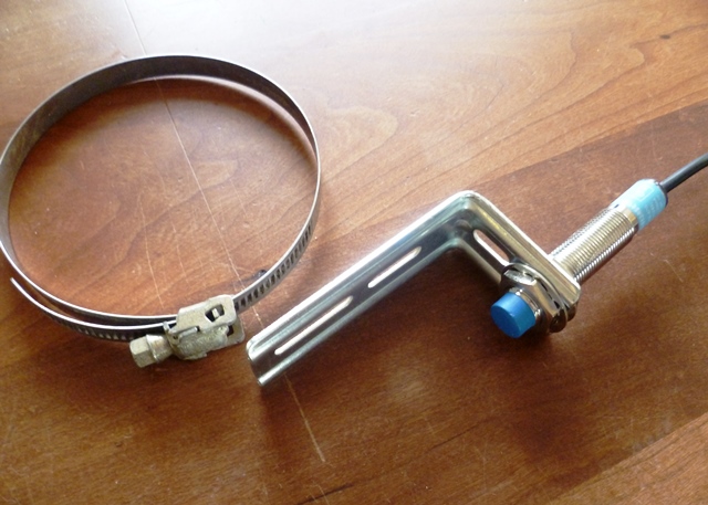

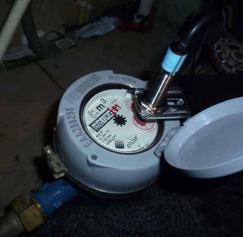

Today i mounted and connected the proximity sensor and got it all working.
So now we are singing "Let it flow, let it flow, let it flow"
Merry Christmas to you all and a big THANK YOU to all involved with Domoticz.
/paul

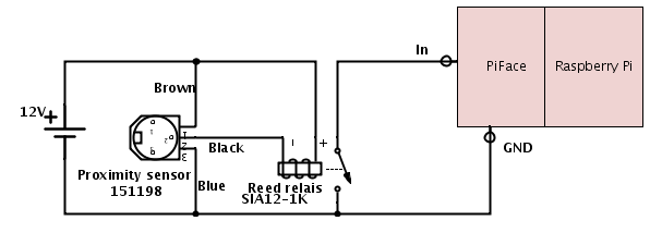

EDIT: Changed the schematic to use a reed relay instead of the 2N7000 Mosfet
