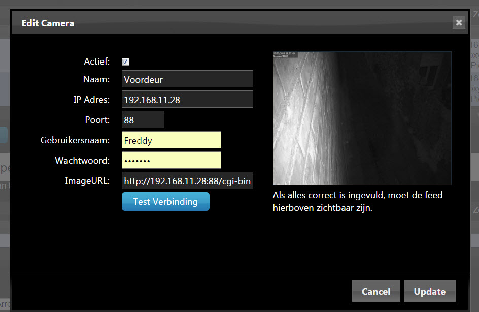

I have a strange problem with a Foscam FI9903P ip camera and I am hoping someone here can help.
I can configure it and I get a picture with "Test Connection" button:

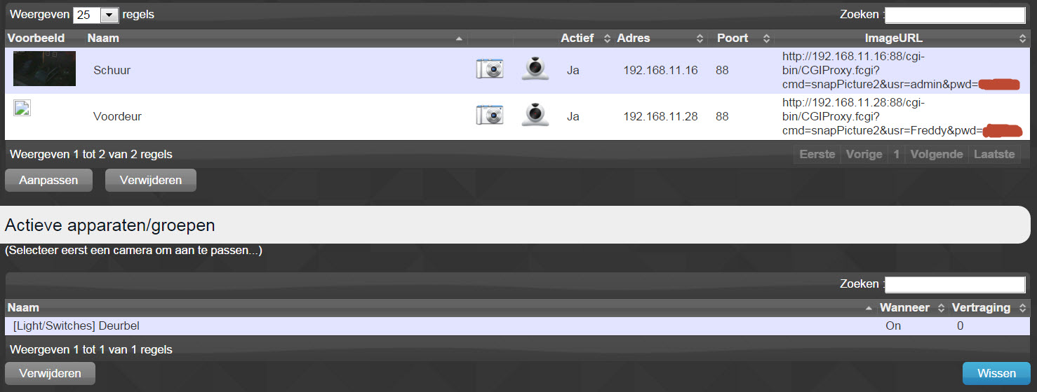

But, there is no preview:

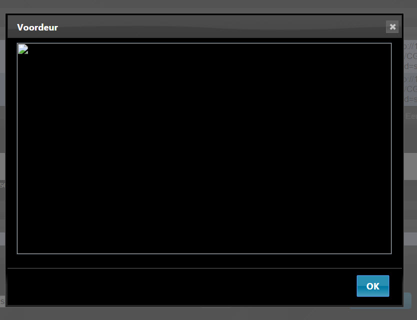

If I click on the webcam icon, there is also no image:

I've a FI9903EP, and the stream is working fine, only the preview is taken from the other cam I have added first (Dericam m601w, a Foscam dome clone (640x480). But the image button is working.
Besided the username and password in the url, it's only working for me when I add both username and password in the desired fields too.

After some "tinkering" I got my camera working again.
When I updated to the latest beta version, my camera is working again. Tried to go back to the latest stable version, problem came back.
So I assume there is a bug in the latest stable version, latest beta version is working fine (3.5010).

Late response - sorry, but the problem is the firmware. The call is returning the HTML response, not the image. Foscam knew about this and fixed it in the firmware - relatively recently.
