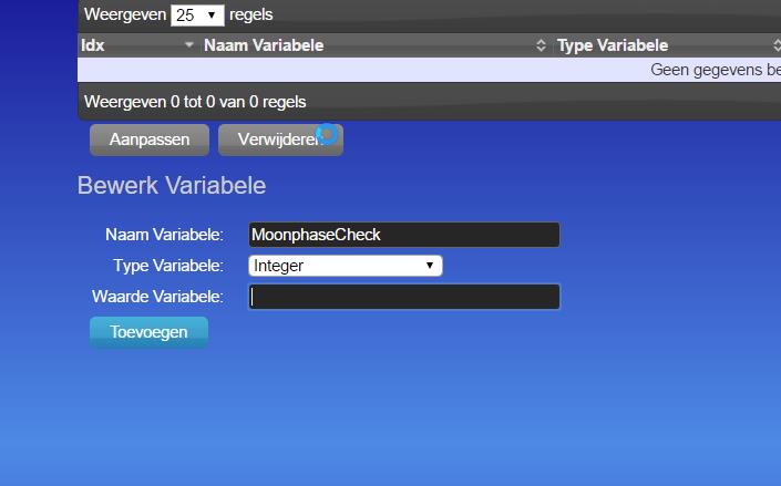

Thanks @alexsh1!
I used your script and modified it somewhat
The result looks like this: As you can see with a Custom sensor that represents the actual moonphase as an icon

-- 1 uservariable "MoonphaseCheck"

local checkvar = "MoonphaseCheck" -- name of the uservar to check if update is allowed

mmm try this get working...
Do i need the city name
Or the station id?
And the variable: Do not understand this function?
Please explane som more...
Nice icon..

The city nameDerik wrote:mmm try this get working...
Or the station id?
The url should look like this:
http://api.wunderground.com/api/<YourwuAPIkey>/astronomy/q/NL/Nijmegen.jsonI'd love to, but I'm not completely sure about what exactly your question/problem is. When looking at your screenshot you're adding a uservariable. I use this variable to determine when the last check (= property lastupdated of this uservariable) was done. At this time plus 3600 seconds ore more the check/update is performed again. The uservariable displays a time, but this is purely cosmetic. The check is performed against the time of the last update.Derik wrote: And the variable:
Does that answer your question/clarifies things somewhat?
