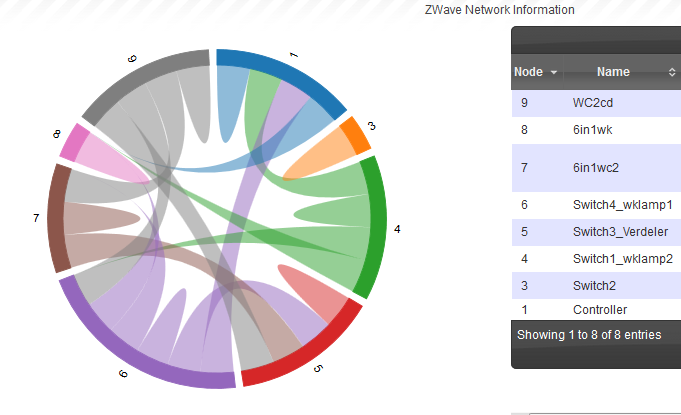

I had the Qubino ZMNHBD1 Flush 2 Relays running for a few weeks (with a Zwave.me USB controller) and was testing some blockly events when suddenly the node appears dead. How could that be? It works or it won't I suppose. How can the node be broken suddenly?
- Z-wave network.PNG (59.08 KiB) Viewed 6756 times
