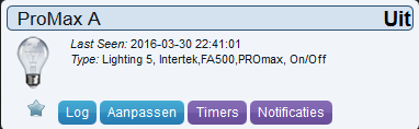

I got it working
Thanks for the super support of RFXCOM by B Weijenberg

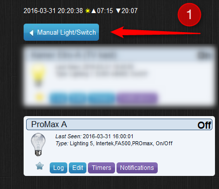

Try to make a manual switch (left side) instead of the learn option (right side). If the PROmax have been linked to the remote, switch the wall plug on then pull it out, plug it back in and press OFF on the remote, this will unlink your remote. Also the Led starts blinking which means it is available for pairing. Then quickly add the switch as per above, press 'Test' button and Domoticz sends out a signal to the wall plug and it works (in my case).

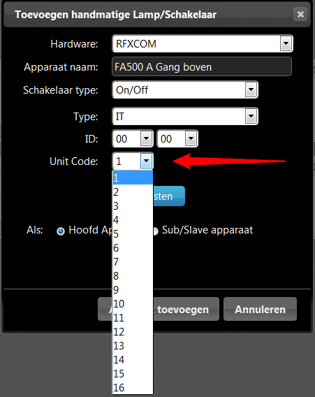

Re: Action Promax

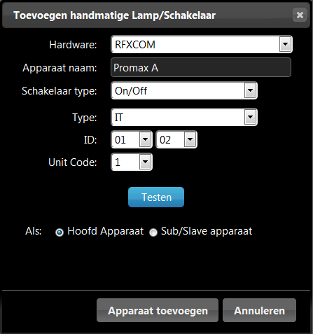

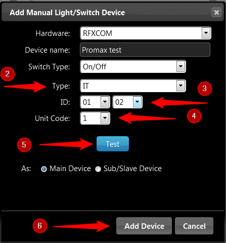

First install the firmware RFXtrx433_Ext2_1001.hex Or newer
If the PROmax have been linked to the remote, switch the wall plug on then pull it out, plug it back in and press OFF on the remote, this will unlink your remote. (thanks jvilly)
(1) Create a manual button (left side)
(2) Set Type to IT
(3) Make ID to 01 and 02 (Use not 00 and 00) otherwise you can use any code
(4) Set Unit Code 1 or 2 or 3 ..........
Now do not use the remote control
(5) Set the switching unit into the wall socket, the LED will blink, and push quickly the test button, before the flashing stops.
(6) Add device
If your the unit accidentally unplugged
Then this is not a problem. Place the unit (connect) the LED flashes again
Press the switch 2 times and the unit will work again with the same code
(2) Set Type to IT
(6) Add device

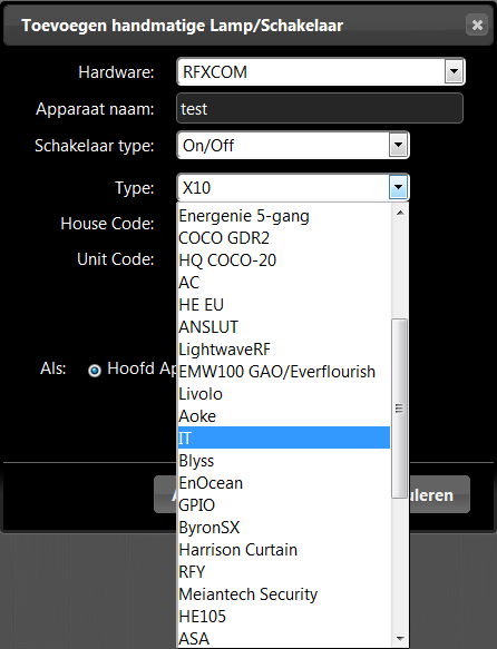

Thanks for the conversation above. Problem is I cant select the type 'IT'. How can i ad this?

1) You do not use RFXtrx433E from RFXCOMRuben wrote:Hello,
Thanks.
Ruben
2) You do not use the firmware RFXtrx433_Ext2_1001.hex
3) select IT
Cobra045
