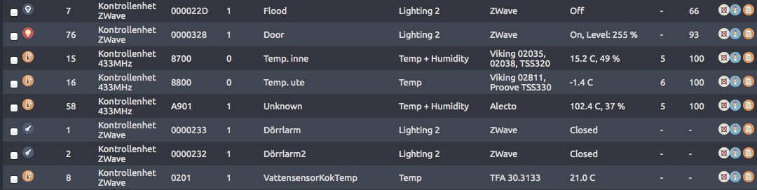

These are the name that I have under devices:

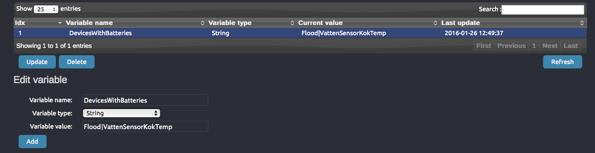

I have the following set for the lua script (johan is the one running domoticz)

You have a mixup on Upeer/Lowercase case characters for VattenSensorKokTemp.
The devicename in the device list is VattensensorKokTemp.
Jos
Jos

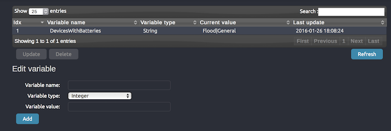

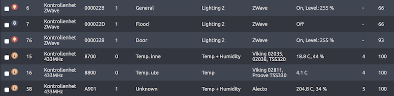

But, I changed it to the below
Still the same error though :/
2016-01-26 18:10:00.267 Error: EventSystem: /home/johan/domoticz/scripts/lua/script_time_battery.lua:42: attempt to concatenate local 'DeviceIDToCheckBatteryLevel' (a nil value)
Ain't it the name from under "devices", and the name that has a battery icon on it you should use?
