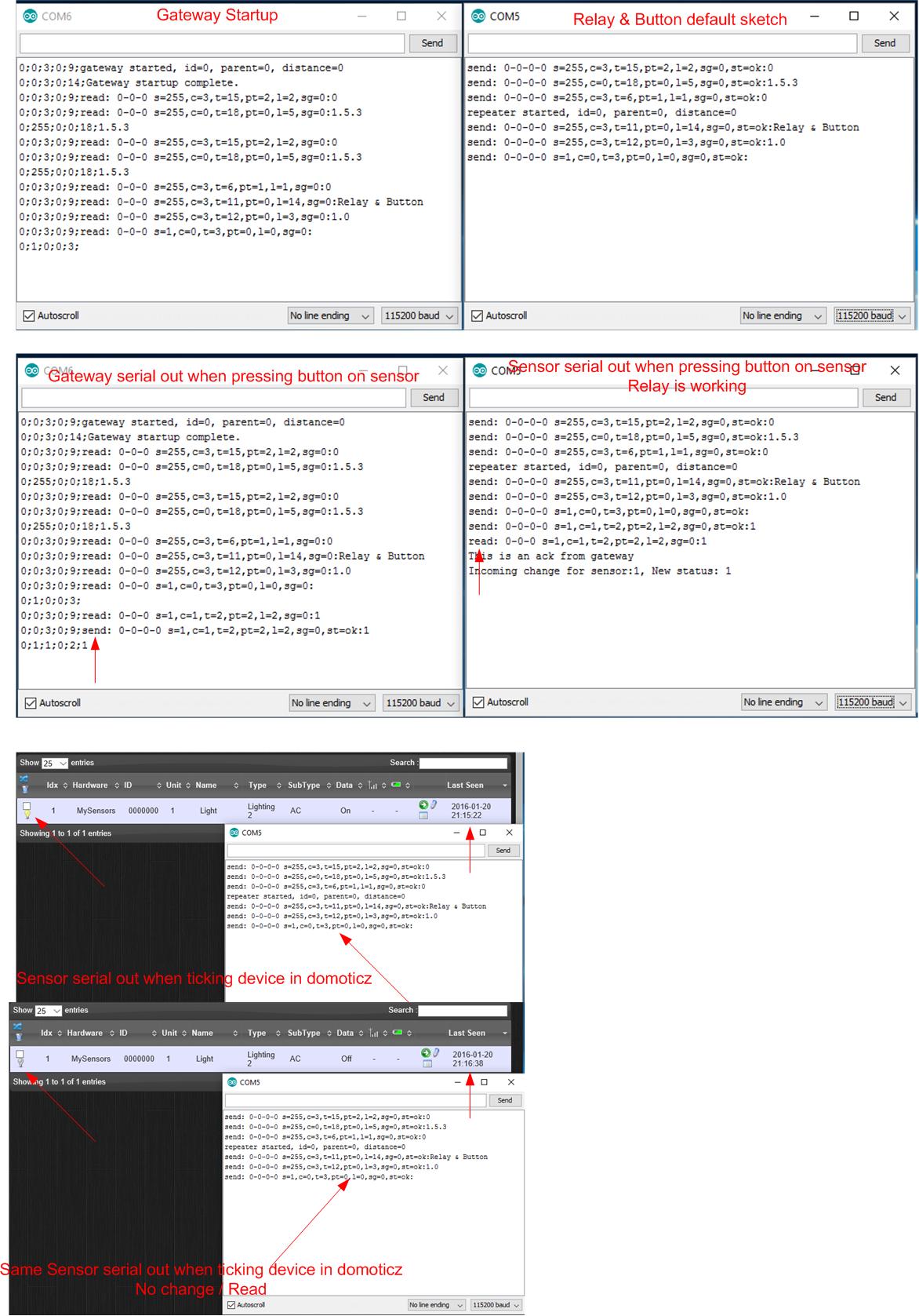

see screenshot below ( click to enlarge)

@postaanerik What is the gateway output when you click in domoticz ?

I actually don't know how to monitor.....using the serial gateway, so the port is used for the communication with Domoticz
