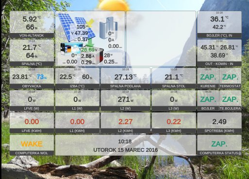

Hi, I want to show you my small modification..
Big thanks to G3rard. I started create my own simmilar forntpage, but when I found this topic and download G3rard's frontpage, lot of time was saved and I made only required modifications..
