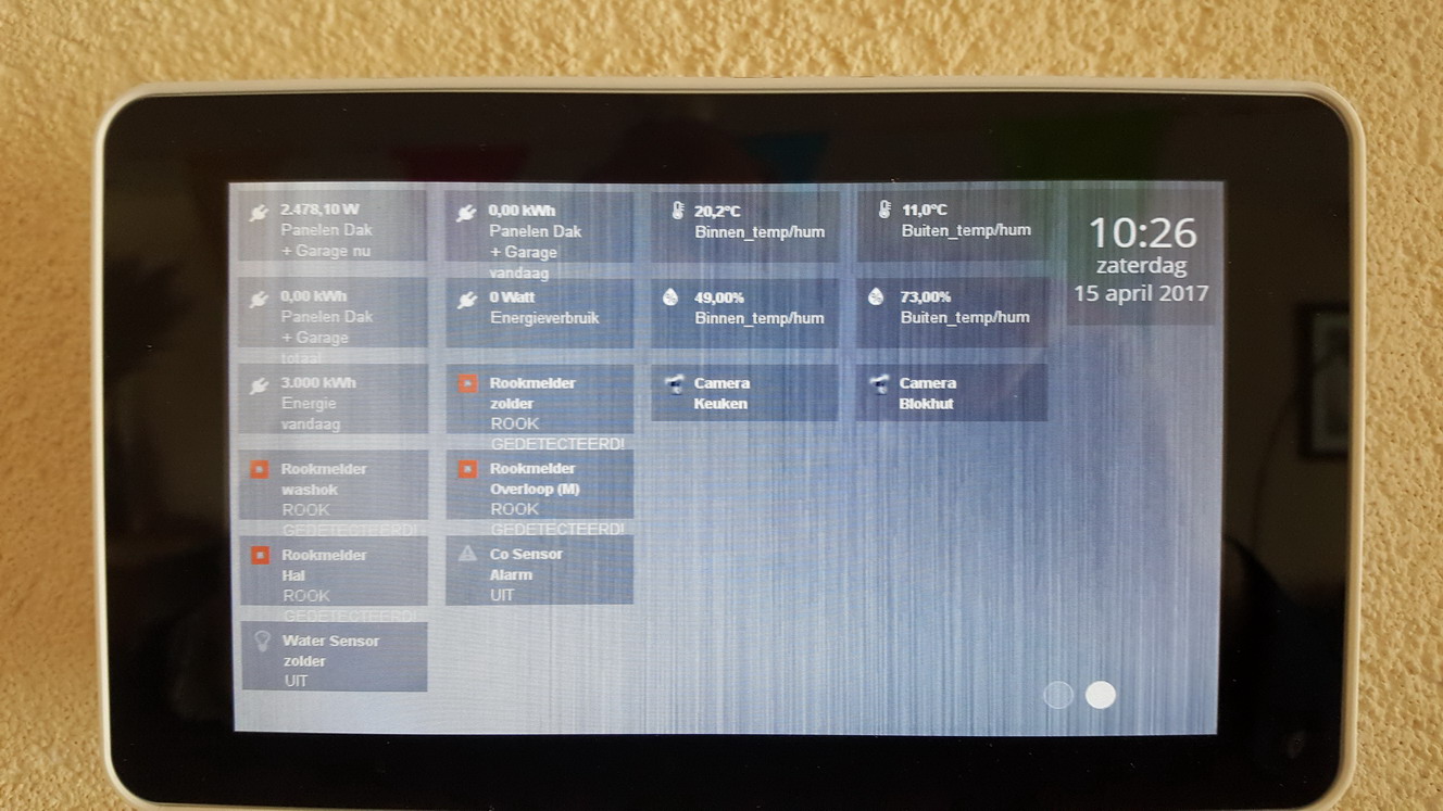

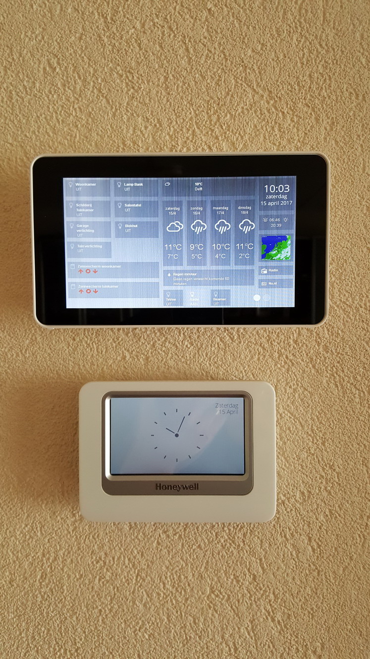

Hi Rob and others,
I follow this topic for a few weeks now and it's really great to see the progress in the development of the dashboard. Thanks for that, and I will make an donation for your tabblet
I made some modifications so the dashboard layout fitts on my 7"Raspii3 touchscreen. See the picture. One thing I can't change is the text that is shown at all "Rookmelders" on page 2. The status is "Normal" but it say's "Rook gedetecteerd", could you please change this in the next release ?
I am still changing the layout of the second screen but it will fit some day.......
John
John

Nice! Care to share?westd001 wrote:I made some modifications so the dashboard layout fitts on my 7"Raspii3 touchscreen.

Looks great.westd001 wrote:Hi Rob and others,

Thansk, really appreciate it!westd001 wrote: I follow this topic for a few weeks now and it's really great to see the progress in the development of the dashboard. Thanks for that, and I will make an donation for your tabblet![]()
Could you send me the output of that device?westd001 wrote: One thing I can't change is the text that is shown at all "Rookmelders" on page 2. The status is "Normal" but it say's "Rook gedetecteerd", could you please change this in the next release ?

Wizjos,
Here is the code, i only changed config.js, creative.js and the background (attached).
config.js:
just changed this part in creative.js:
Rob, this is the output of a "Smoke detector"
config.js:
var _LANGUAGE = 'nl_NL'; //or en_US
var _HOST_DOMOTICZ = 'http://192.168.x.x:xxxx';
var _HOST_ZIGGO_HORIZON = ''; //e.g. http://192.168.1.3/domoticz/switch_horizon.php';
var _APIKEY_WUNDERGROUND = 'xxxxxxx';
var _WEATHER_CITY = 'Delft';
var _WEATHER_COUNTRY = 'NL';
var _USE_AUTO_POSITIONING = false; //don't want to configure positions, use auto positioning
var _USE_FAVORITES = false; //only used when using auto positioning
var _HIDE_SECONDS_IN_CLOCK = true; //do not show the seconds in the clock
var _NEWS_RSSFEED = 'http://www.nu.nl/rss/algemeen';
var _USE_FAHRENHEIT = false;
var _STANDBY_AFTER_MINUTES = false; //enter amount of seconds like: 5 (5 seconds)
var buttons = {}
buttons.buienradar = {width:12, isimage:true, image: 'http://api.buienradar.nl/image/1.0/RadarMapNL?w=285&h=256', url: 'http://www.weer.nl/verwachting/nederland/son/189656/'}
buttons.camerakeuken = {width:6, image: 'img/SecurityCam.png', title: 'Camera Keuken', url: 'http://192.168.x.x:xxx/snapshot.cgi?user=xxxx&pwd=xxxxx&rate=1'}
buttons.camerablokhut = {width:6, image: 'img/SecurityCam.png', title: 'Camera Blokhut', url: 'http://192.168.x.x:xxxx/snapshot.cgi?user=xxxx&pwd=xxxxx&rate=1'}
"CUSTOM POSITIONING:"
//defining wich blocks to show, de numbers represents the IDX of the device in Domoticz
//only define if you want to use a custom width instead of the default
var blocks = {}
blocks[12] = {}
blocks[12]['width'] = 6;
blocks[64] = {}
blocks[64]['width'] = 6;
blocks[66] = {}
blocks[66]['width'] = 6;
blocks[109] = {}
blocks[109]['width'] = 6;
blocks[116] = {}
blocks[116]['width'] = 6;
blocks[423] = {}
blocks[423]['width'] = 6; //1 to 12, remove this line if you want to use the default (4)
blocks[425] = {}
blocks[425]['width'] = 6;
blocks[435] = {}
blocks[435]['width'] = 6;
blocks[436] = {}
blocks[436]['width'] = 12;
blocks[443] = {}
blocks[443]['width'] = 12;
blocks[479] = {}
blocks[479]['width'] = 6;
blocks[485] = {}
blocks[485]['width'] = 6;
blocks[536] = {}
blocks[536]['width'] = 6;
blocks[576] = {}
blocks[576]['width'] = 6;
blocks[577] = {}
blocks[577]['width'] = 6;
blocks[716] = {}
blocks[716]['width'] = 6;
blocks[743] = {}
blocks[743]['width'] = 6;
blocks[753] = {}
blocks[753]['width'] = 6;
blocks[801] = {}
blocks[801]['width'] = 6;
blocks[813] = {}
blocks[813]['width'] = 3;
blocks[814] = {}
blocks[814]['width'] = 3;
blocks[815] = {}
blocks[815]['width'] = 3;
blocks[816] = {}
blocks[816]['width'] = 3;
blocks[833] = {}
blocks[833]['width'] = 6;
blocks[841] = {}
blocks[841]['width'] = 6;
blocks[842] = {}
blocks[842]['width'] = 6;
blocks[843] = {}
blocks[843]['width'] = 12;
blocks['currentweather'] = {}
blocks['currentweather']['width'] = 12;
blocks['blocktitle_1'] = {}
blocks['blocktitle_1']['title'] = 'Schakelaars';
blocks['blocktitle_2'] = {}
blocks['blocktitle_2']['title'] = 'Weersvoorspelling';
//defining number of columns, their contents en widths
//width can be a number 1 to 12, but total widths of all columns should always be 12
var columns = {}
columns[1] = {}
columns[1]['blocks'] = [753,716,425,743,66,423,485,436,443] //remark: idx 144 produces 2 blocks, so you can use: '144_1' and '144_2' (or of course, just 144 if you want one)
columns[1]['width'] = 5;
columns[2] = {}
columns[2]['blocks'] = ['currentweather','weather',843,814,815,816]
columns[2]['width'] = 5;
columns[3] = {}
columns[3]['blocks'] = ['clock','sunrise',buttons.buienradar,buttons.radio,buttons.nunl]
columns[3]['width'] = 2;
columns[4] = {}
columns[4]['blocks'] = [64,833,109,116,576,577,479,801]
columns[4]['width'] = 5;
columns[5] = {}
columns[5]['blocks'] = ['12_1','536_1','12_2','536_2',buttons.camerakeuken,buttons.camerablokhut]
columns[5]['width'] = 5;
columns[6] = {}
columns[6]['blocks'] = ['clock']
columns[6]['width'] = 2;
//if you want to use multiple screens, use the code below:
var screens = {}
screens[1] = {}
screens[1]['background'] = 'brushed-metallic-backgroud800x480_3.jpg';
screens[2] = {}
screens[2]['background'] = 'brushed-metallic-backgroud800x480_3.jpg';
screens[2]['columns'] = [4,5,6]
.slider-pagination {
position: absolute;
bottom: 20px;
width: 95%;
left: 0;
text-align: right;
z-index: 1000;
"AddjMulti" : 1.0,
"AddjMulti2" : 1.0,
"AddjValue" : 0.0,
"AddjValue2" : 0.0,
"BatteryLevel" : 255,
"CustomImage" : 0,
"Data" : "Normal",
"Description" : "",
"Favorite" : 0,
"HardwareID" : 3,
"HardwareName" : "RFXCOM",
"HardwareType" : "RFXCOM - RFXtrx433 USB 433.92MHz Transceiver",
"HardwareTypeVal" : 1,
"HaveDimmer" : false,
"HaveGroupCmd" : false,
"HaveTimeout" : false,
"ID" : "6B9D00",
"LastUpdate" : "2017-04-07 13:27:43",
"MaxDimLevel" : 0,
"Name" : "Rookmelder Overloop (M)",
"Notifications" : "true",
"PlanID" : "5",
"PlanIDs" : [ 5, 6 ],
"Protected" : false,
"ShowNotifications" : true,
"SignalLevel" : 4,
"Status" : "Normal",
"StrParam1" : "",
"StrParam2" : "",
"SubType" : "KD101 smoke detector",
"SwitchType" : "Smoke Detector",
"SwitchTypeVal" : 5,
"Timers" : "false",
"Type" : "Security",
"TypeImg" : "smoke",
"Unit" : 0,
"Used" : 1,
"XOffset" : "0",
"YOffset" : "0",
"idx" : "576"
},- Attachments
- brushed-metallic-backgroud800x480_3.jpg (59.1 KiB) Viewed 2686 times
