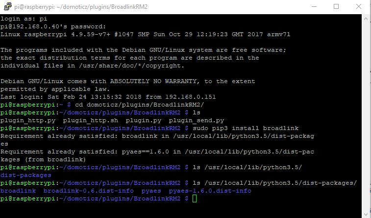

I have just installed 3.4 python, and set it as default with this article:
https://linuxconfig.org/how-to-change-f ... bian-linux
but the crash is the same. Now realized that probably the default python was 2.7, and I have now tried 3.4, but maybe 3.5 was not yet tried
So will try now the 3.5 as well.

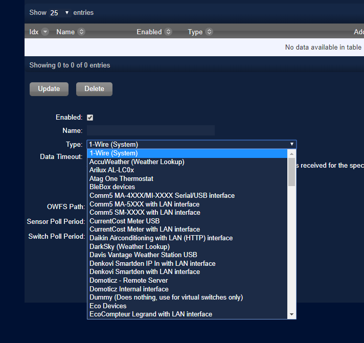

Hi again from my side
because I wanted to use aurora theme I installed the latest beta release of domoticz (3.8944).
With my Backup (stable version) I have no problem with the broadlink plugin.
Within the beta release i tried to include the plugin as well like I did it in the stable version.
The problem is that i can't see the Broadlink hardware...
When I backup my stable version everything is fine... Any ideas what is wrong?

I now reinstalled Crypto, pyaes, broadlink, i changed between Python 2.7 to 3.5. Ich edited plugin_http.sh so that it fits to my path, i tried all i can but nothing.
If i copy the Pluginfiles to Pluginfolder and restart domoticz everything is ok.
Just in the moment i add Broadlink as new Hardware in domoticz, my domoticz exited. If i only remove the plugin.py from the Pluginfolder and restart then again everything is fine.
What must i do to get this running with domoticz?
Domoticz running on rpi3.
python 2.7, 3.4 and 3.5 are present.
Operating System: Raspbian GNU/Linux 9 (stretch)

I think i got it now. And what should i say? It was a rights Problem on my Rpi. raspbian installed as user pi, domoticz as user domoticz, all stuff what need sudo to work is user root. So there is one of the biggest problem. Also my domoticz only starts with sudo, every folder and file generated by domoticz has only root rights.
So i changed owner and rights and now the Plugin works.
Only one issue left, on http my Hardwarepage is empty, on https the hardwarepage works perfect.
Now im working on my imported remotes. I have 2 RF remotes with 4 on and 4off Buttons. In the smartphone app its shown as one remote. But after import i have 16 single switches in domoticz, all work as Power on. That works, but its not so nice.
Is there any way to tell domoticz wich switches have to work together as on/off switch?

Re: Python Plugin : Broadlink RM2 V4
Perhaps but I don't understand why it does not run in the beta version but well with the stable version. I did a updaterelease and now it works except some of my xiaomi devices
... and this only on my Pi because I have the last domoticz beta running under win10 without problem.
- Posts: 49
- Joined: Sunday 07 January 2018 19:23
- Domoticz version: newest
- Location: Stuttgart
Clement, i think its only a rights Problem...
