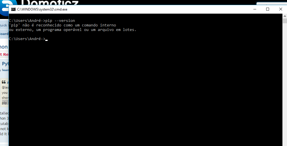

In the CMD it displays the following error:
'pip' is not recognized as an internal or external command, an operable program or a batch file.Image
cmd
cmd
zak45
Posts: 954
Domoticz version: V2024.4
Re: Python Plugin : Broadlink RM2 V4
Post by zak45 »
So... in 3.5.4 should be included.. do you have follow all recommendations ( include in path.. all users ...) ?
Google is your friend.:)

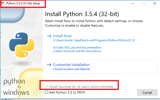

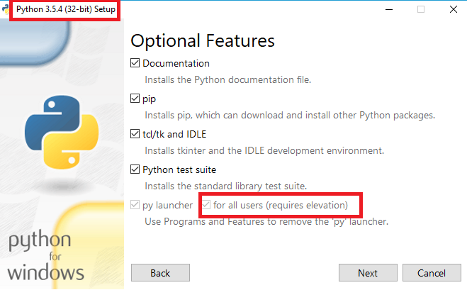

Here are some photos of the installation and modification of the installation:

Maybe mark the option "Add python 3.5 to path" this will do that you can run python from any location without going to that folder first.

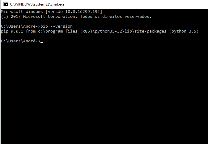

Good!!! Now it was okay to execute the "pip version" command by the CMD.
Look at the version:
Pip Version.png (10.73 KiB) Viewed 4302 times
zak45
Posts: 954
Post by zak45 »
leandrosaltori wrote: Wednesday 14 February 2018 20:01 Good!!! Now it was okay to execute the "pip version" command by the CMD.
Great.. now execute setup.exe.

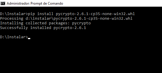

zak45
Posts: 954
Post by zak45 »
Download pycrypto-2.6.1-cp35-none-win32.whl from dropbox and install it manually
open cmd with admin right
go to the folder where pycrypto-2.6.1-cp35-none-win32.whl is located and type:
pip install pycrypto-2.6.1-cp35-none-win32.whl
leandrosaltori
Posts: 23
Joined: Tuesday 06 February 2018 20:04
Post by leandrosaltori »
zak45 wrote: Wednesday 14 February 2018 20:16 Download pycrypto-2.6.1-cp35-none-win32.whl from dropbox and install it manually

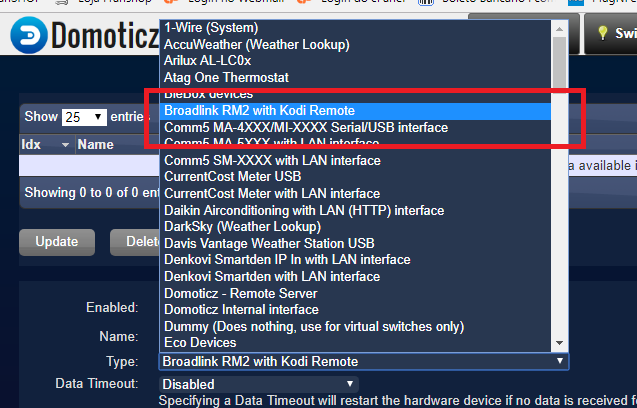

Show, you're the best! I made the installation of this file by CMD and now it works.
BROADLINK has appeared.
Now it's gettin to set up Broadlink with Domoticz.
Thank you very much for your attention !!
