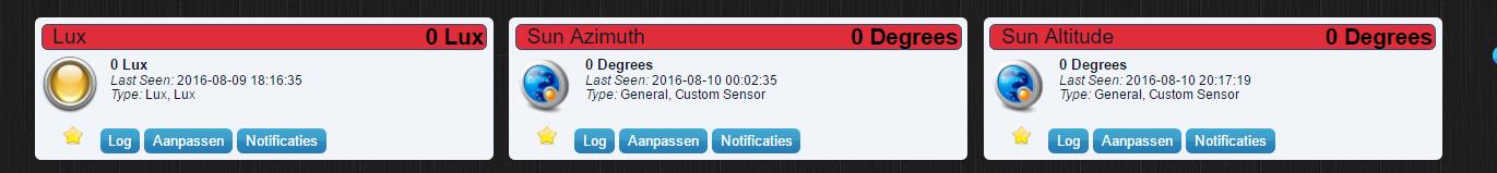

Re: Real-time solar data : azimuth, Altitude, Lux sensor...
I did all the things in the wiki.
Only my script is not working.
I did not get the:
And my log error:
I did not get the:
Your home altitude : run once in debug = 1 to found your altitude in Log and write it here
2016-08-20 12:55:00.557 Error: EventSystem: in /home/linaro/domoticz/scripts/lua/script_time_SolarSensor.lua: .../linaro/domoticz/scripts/lua/script_time_SolarSensor.lua:56: attempt to call a nil valueXu4: Beta Extreme antenna RFXcomE,WU Fi Ping ip P1 Gen5 PVOutput Harmony HUE SolarmanPv OTG Winddelen Alive ESP Buienradar MySensors WOL Winddelen counting RPi: Beta SMAspot RFlinkTest Domoticz ...Different backups

@Derik:

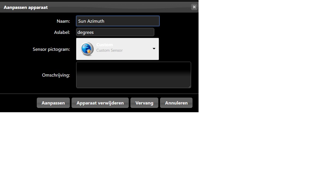

I noticed three different things in your setup:
- The names of the custom sensors should be :"Sun Azimuth" and "Sun Altitude" Exactly like in the wiki.
- In the box of these custom sensors (click on "aanpassen") Type at the field "Aslabel" the word 'degrees' at both custom sensors.
- The name of the Weather Underground location voor Nijmegen should be "Nijmegen" or try "Molukkenstraat" You used the Weather Underground codename of the station in your script. During installation I got the same failure message. Once I changed the name in the script, all went right.
(Molukkenstraat (INIJMEGE14)
Give it a try!
Give it a try!

@ VMB [ From Nijmegen??
I did what you say..
Only the wiki has some errors i think

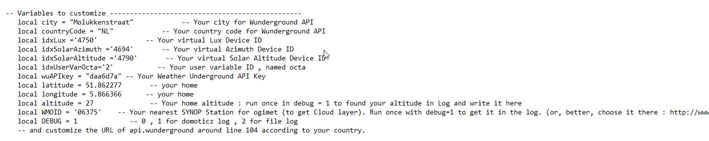

The Wiki: And what you says:[ and i have ] Only i think i don not now how i run in debug for 1 time:
While i got this setting:
Changed my api.
local altitude = 27 -- Your home altitude : run once in debug = 1 to found your altitude in Log and write it here
local WMOID = '07145' -- Your nearest SYNOP Station for ogimet (to get Cloud layer). Run once with debug=1 to get it in the log. (or, better, choose it there : http://www.ogimet.com/gsynop_nav.phtml.en )
local DEBUG = 0 -- 0 , 1 for domoticz log , 2 for file logXu4: Beta Extreme antenna RFXcomE,WU Fi Ping ip P1 Gen5 PVOutput Harmony HUE SolarmanPv OTG Winddelen Alive ESP Buienradar MySensors WOL Winddelen counting RPi: Beta SMAspot RFlinkTest Domoticz ...Different backups

@Derik,

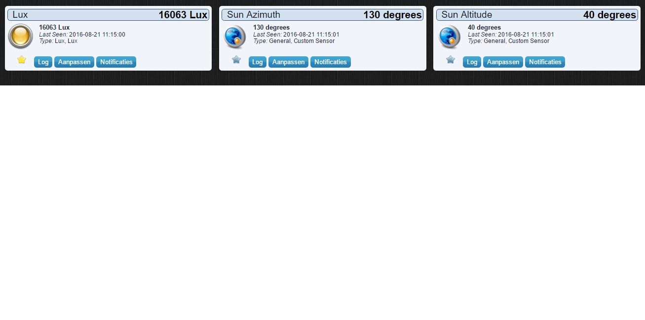

Here is my script; only changed the WU-api
-- Variables to customize ------------------------------------------------
local city = "Liesveld" -- Your city for Wunderground API
local countryCode = "NL" -- Your country code for Wunderground API
local idxLux ='428' -- Your virtual Lux Device ID
local idxSolarAzimuth ='429' -- Your virtual Azimuth Device ID
local idxSolarAltitude ='430' -- Your virtual Solar Altitude Device ID
local idxUserVarOcta='7' -- Your user variable ID , named octa
local wuAPIkey = "6e4404XXX" -- Your Weather Underground API Key
local latitude = 51.885823 -- your home
local longitude = 4.662413 -- your home
local altitude = -2 -- Your home altitude : run once in debug = 1 to found your altitude in Log and write it here
local WMOID = '06344' -- Your nearest SYNOP Station for ogimet (to get Cloud layer). Run once with debug=1 to get it in the log. (or, better, choose it there : http://www.ogimet.com/gsynop_nav.phtml.en )
local DEBUG = 1 -- 0 , 1 for domoticz log , 2 for file log
-- and customize the URL of api.wunderground around line 104 according to your country.
-- Below , edit at your own risk ------------------------------------------
vmb
- Posts: 26
- Joined: Thursday 02 October 2014 14:35
And here is my JSON.lua in a rar file. Unrar it and place it in script-dir (same dir as where Solar script is placed)
- JSON.rar
- (9.48 KiB) Downloaded 200 times

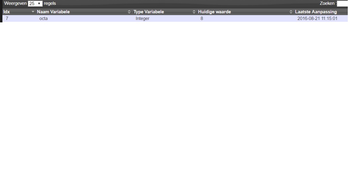

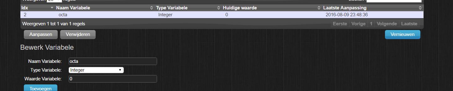

How do you come to otca value 8?
And do i need to rename the JSON.lua to script_time_JSON.lua?

My octa is 7 because I use other variables. Thats why this is number 7.Derik wrote:mmm
Json extract from rarfile. Leave name as it is.

my dummy's are red..

From the original wiki
without weathe underground you need to repalce that with:
or read it from a pressure sensor...
That yould fix your nil... now I am also stuck on the cloud coverage not coming in....
-- API Wunderground
local config=assert(io.popen('curl http://api.wunderground.com/api/'..wuAPIkey..'/conditions/q/'..countryCode..'/'..city..'.json'))
local location = config:read('*all')
config:close()
local jsonLocation = json:decode(location)
if( DEBUG == 1) then
local latitude = jsonLocation.current_observation.display_location.latitude
local longitude = jsonLocation.current_observation.display_location.longitude
local altitude = jsonLocation.current_observation.display_location.elevation
print('Lat: '..latitude..'Long: '..longitude..'Alt: '..altitude)
relativePressure = jsonLocation.current_observation.pressure_mb -- if you have an another way to get the Pressure, (local barometer ...) then you may optimize the script and avoid the call to api.wunderground)
relativePressure = 1012
