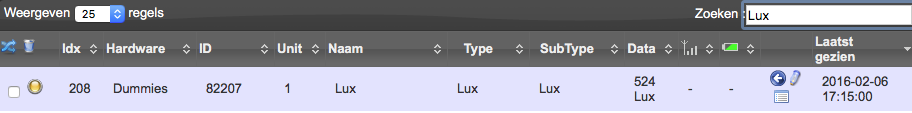

stefanvn
Joined: Saturday 06 February 2016 10:02
Re: Real-time solar data : azimuth, Altitude, Lux sensor...
Post by stefanvn »
Hi Jimlegise,
Thanks for your reply. I tried your suggestion in a small script:
ommandarray={}
if tonumber(otherdevices_svalues['Lux'])>1000 then print("on")
return commandarray
Again, I'm getting an error message:
lua: luxswitch.lua:2: attempt to index global 'otherdevices_svalues' (a nil value)
stack traceback:
luxswitch.lua:2: in main chunk
[C]: ?
Here is my Lux device:
Perhaps I'm missing something. I'm not a coding expert, sorry.
Westcott
Posts: 423
Joined: Tuesday 09 December 2014 17:04
Location: UK - Glos
Post by Westcott »
What happens if you try -
print(otherdevices_svalues['Lux'])
Also check its value in Setup->More options->Events->Show Current States
Is it the only device called Lux?
stefanvn
Post by stefanvn »
Still not working....I'm getting a bit frustrated. Seems to me that I'm missing something obvious or something.
What I did sofar:
* Check value in Setup->More options->Events->Show Current States: Value is present.
* Check whether it is the only device called "Lux": it is.
* print(otherdevices_svalues['Lux']): same error message (attempt to index global 'otherdevices_svalues' (a nil value)).
* Removed Lux device and re-created a new dummy Lux device: Device gets updated with Luxvalue, but print(otherdevices_svalues['Lux']) still gives the same error message.
Seems to me that it shouldn't be that hard to retrieve such a value, but apparently it is too difficult for me ;-)
I would love to get some more hints and tips, in order to get this working.
