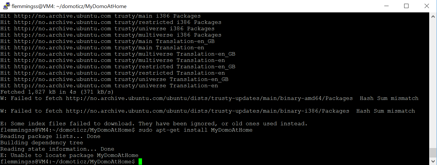

I have used MyDomoAtHome on Ubuntu server a long time now, but how do I update it to a newer version? can't find any info on that.
sudo apt-get update
sudo apt-get install MyDomoAtHome
gives me:
sudo apt-get update
gives me:

the 0.2.7 is the latest version, see here:Evelen wrote:I have used MyDomoAtHome on Ubuntu server a long time now, but how do I update it to a newer version? can't find any info on that.
sudo apt-get update
gives me:
http://www.e-nef.com/domoticz/mdah/
if you were on the perl version, or if you haven't set the debian update automatically see:
https://github.com/empierre/MyDomoAtHome

Hi, Can you maybe give me the commands I need to run?epierre wrote:the 0.2.7 is the latest version, see here:Evelen wrote:I have used MyDomoAtHome on Ubuntu server a long time now, but how do I update it to a newer version? can't find any info on that.
sudo apt-get update
gives me:

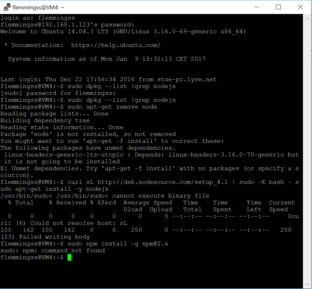

It looks like you are trying to run 2 commands as one...Evelen wrote:Hi, Can you maybe give me the commands I need to run?
1) sudo apt-get remove node (not needed, since you dont have node)
2) curl -sL https://deb.nodesource.com/setup_4.x | sudo -E bash -
3) sudo apt-get install -y nodejs

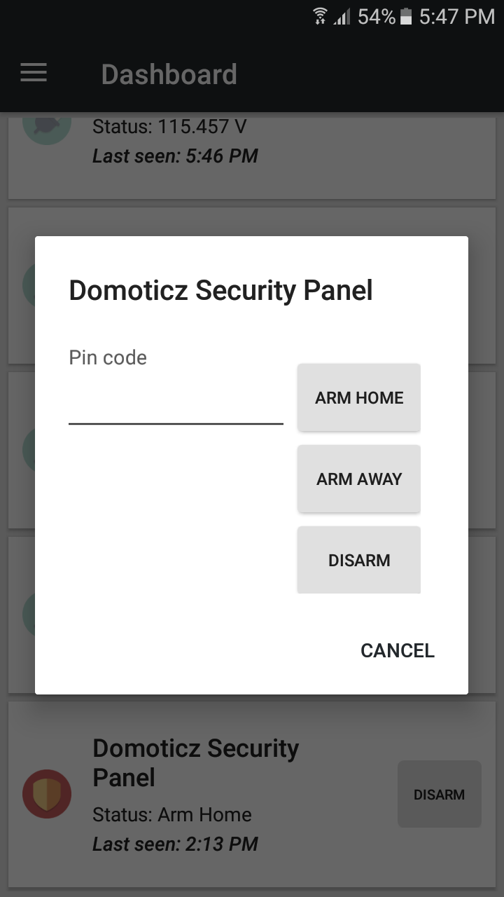

Not sure this is the right place ..
Configuration :
- RPi3
- Version stable v3.5877
- Imperihome V2.8.5 (android)
I have setup the security panel in Domoticz and it is displayed in the dashboard.
I can ARM DISARM from the utility place in Domoticz .
It is working also in the android Domoticz Lite app.
But there a problem in the android imperihome app , I can create the widget and the Arm mode is displayed in the widget but when clicking in the widget nothing is proposed to change the house mode as for the Domoticz app.
However changing the mode in security panel is correctly displayed in Imperihome ( armhome , arm away)
The imperihome widget #1 is used (from the top of the screen) , the widget #2 does not worked , the widget #3 is the same than widget #1 with text instead of icon.
Q1 : Does anybody is using this configuration ?
Q2 : Wireshark is not catching messages from/to the IP of Imperihome phone ?
Attached the sreenshot of the domoticz app =OK
Configuration :
- RPi3
